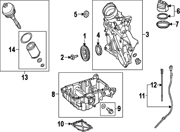

Looking underneath the car you can see where the oil dipstick fits into the oil pan. Given the complex curves of the dip stick port at the bottom prior to getting into the sump, I would guess that even bottoming out the vacuum tube of the Mitevac in the dipstick port would only allow you to get about 90% of the oil out of the sump.
Can you go a little further in describing this or even circle the area where the dipstick fits into the oil pan? I only have the parts diagram and the dipstick tube doesn't look like it has any complex curves, but it also doesn't show where exactly it comes into the upper or lower oil pan (see item #11 & 12).

Here you go...
As you can see, the entry point of the dip stick doesn't even get anywhere near the deepest part of the sump. Think about it; the oil level notches in the dip stick end are about 2 inches apart from "low" to "full". I can promise you the oil sump is deeper than 2 inches.

Originally Posted by Myron Ybarra
Here you go...
From the diagrams, is certainly does appear that the bottom of the sump is not in the range of the dipstick. However, I now ask why do you think that MB uses a vacuum pump when it may not reach the bottom of the sump? Perhaps, their pump has an extension? BTW, I've changed the oil on my 2 previously owned two new BMWs (annually for a total of 14 years for the two cars) via a pump and when I sold the cars (both 11 years old with 45K and 65K miles) their engines purrrrred. Furthermore, I as my car is leased for three years, I'll be pumping it myself and doubt if there will be any problems when I return the car to MB.
I believe MB techs use the pump for convenience sake, although who's to say. I can't comment on the good fortune of your experience with using a pump vs draining the oil sump and the resulting purring engines, lol. I can say with tighter piston ring to cylinder wall clearances, I don't want to mix very much suspended solids and/or fuel contaminated old oil with new oil so I'll be draining the conventional way. That way, I'm virtually assured that I'll have no internal engine issues as a result of mixing large amounts of old with new oil. FYI, even with draining at the sump, there is oil inside the engine (up in the head, in the HLA's and in the oil passages throughout the engine) that can't be drained so I'm aware that there will be some level of mixing old with new oil. I just want to minimize that amount by draining at the sump.

I plan to do the vacuum method once we hit 10k miles. Since our car is a lease, it should be fine.
Even though the dipstick doesn't reach down, I'm curious how much I'll be able to extract since the extraction tube goes way further down than the actual dipstick. Once we hit 10k miles (we're only at 2k now), I'll try to remember to report back!
