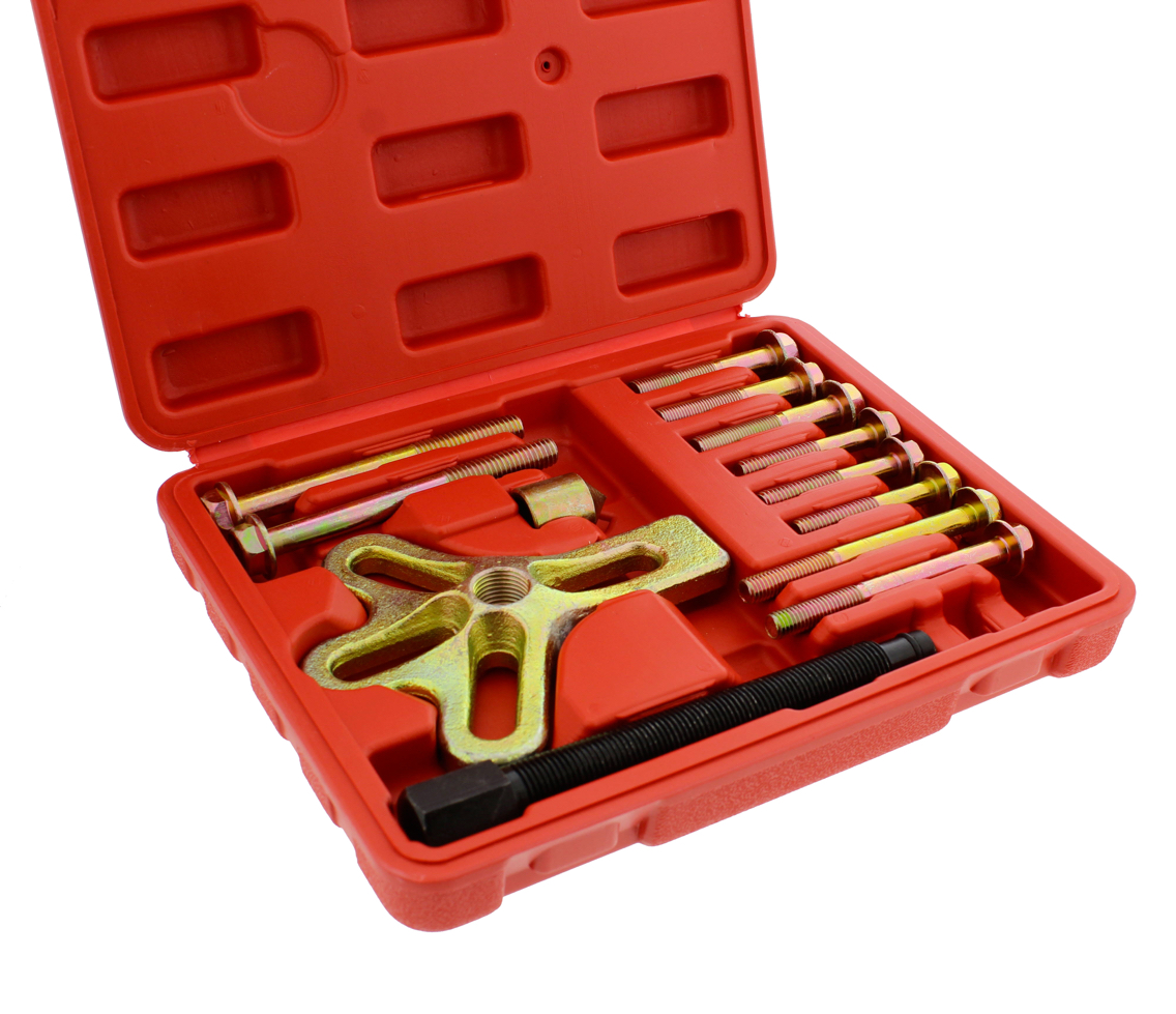

You need to buy or borrow a steering wheel puller. The wheel is splined onto the shaft. Comes right off with a puller.

The nut has to come off, and then you'd use the puller to get the wheel off the shaft itself.

I guess you'll find out. If it puts up a fight after the bolt is out, use a puller.

You dont need a puller!!, just release the bolt and the steering wheel comes off,
Stop trying to help if you dont know how to do it!?

Sorry. I misread the first post and thought he was planning on using a breaker bar on the wheel vs the nut.

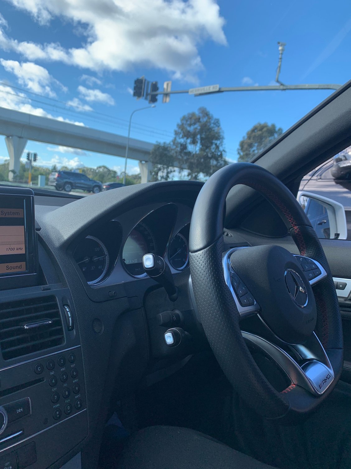

I was trying to contact Chris but I couldnt.
I have installed this steering wheel and this column (clock string). Everything works (buttons, lights, etc) but the paddles shifts don't. As I was reading down all your replies I am thinking about ordering the A212 900 29 24 that a mate bought. But I want first that whoever solved this problem confirm this is the way to solve this problem.

did you solve your problem...I'm very frustrated atm trying to find the right steering wheel and column spring with the paddle shifters...went to garage just now they tried to put the wheel and and no buttons would work but they didn't have paddle shifters on them anyway...feels like a waste journey just want to upgrade my wheel

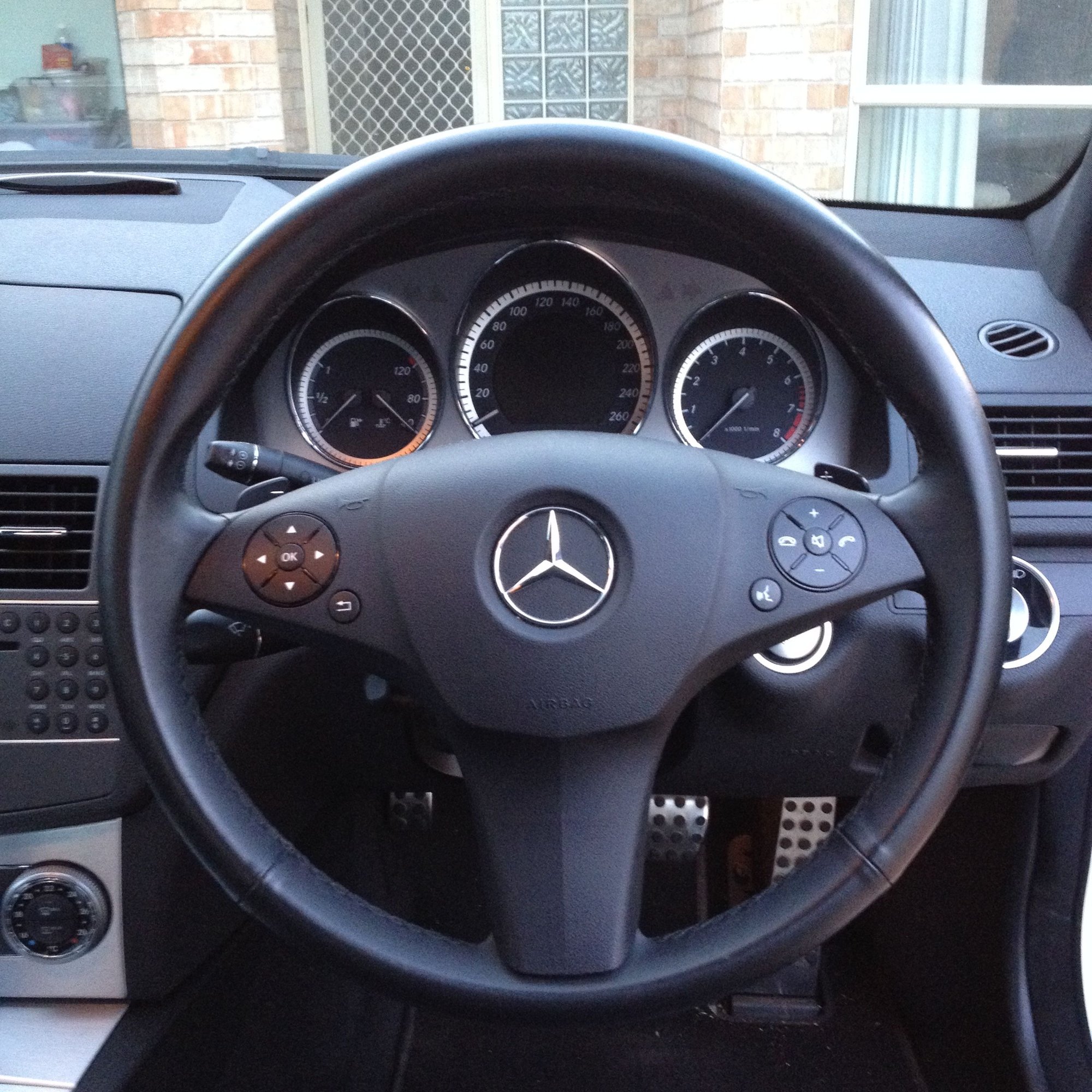

Firstly do you have a C Class or E class, it really doesn't matter, what does is if your vehicle is a sedan or estate. From your picture it appears that you have a clock spring (also referred to as a combination switch) that is found on an estate or hatch back on account of the stalk that has the regulator/switch for a rear wiper. Clock springs are very unique and you have to make sure that it is compatible with the type of vehicle you have, that is if you have a sedan you can't just put in one that is for a estate or hatch back as that is where your problems start.
Also read comment #351.
