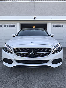

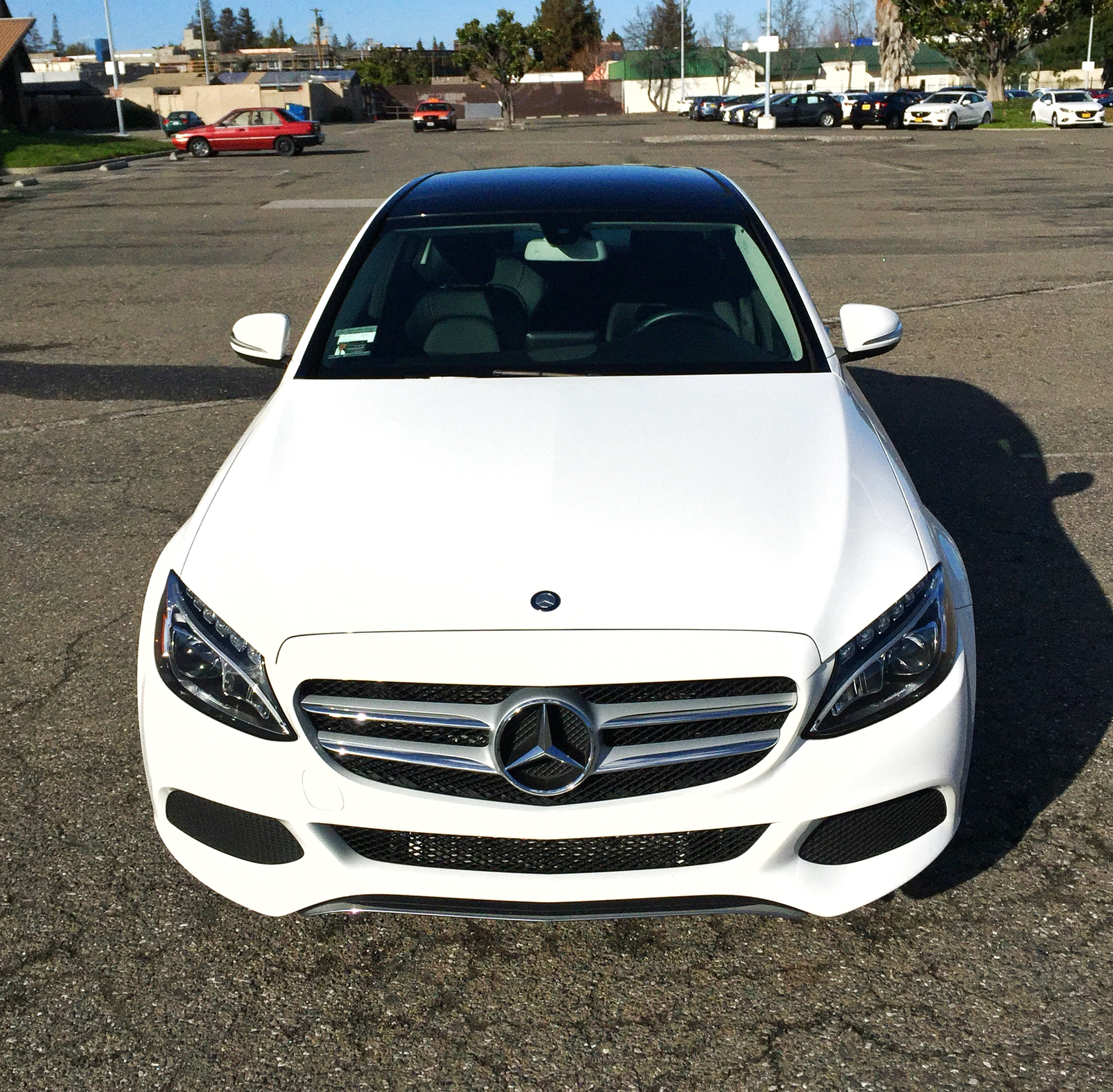

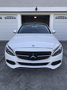

Finally I got this done by myself on wifey’s car! Here is a before and after pic!OEM grill to Diamond Grill swap-photo480.jpgOEM grill to Diamond Grill swap-photo431.jpgOEM grill to Diamond Grill swap-photo708.jpg

how much did you pay for the grill and how hard was the swap?
Old Oct 9, 2017 | 02:58 AM
Krypton's Avatar
Joined: Jan 2016
Posts: 168
Likes: 13
From: South bay
2015 C300 and BMW 328i E90 LCI
Paid $90 for the grill and since it was my first time and I was working with the crappy instructions from this forum and no other help, it took me a total of 6 hours but out of that I will give 1.5 hours to trying to get the grill off without putting the car on jack stands to get to the underpanel so I can remove the additional two bolts that brings the bumper completely out. Gave up on that and then it was about 2 hours. The grill being aftermarket was a b**** to put in but a little bit of muscle got all the clips in order and you see the result!
If I had to do this again by myself, it would take me not more than 1.5 hours total.
