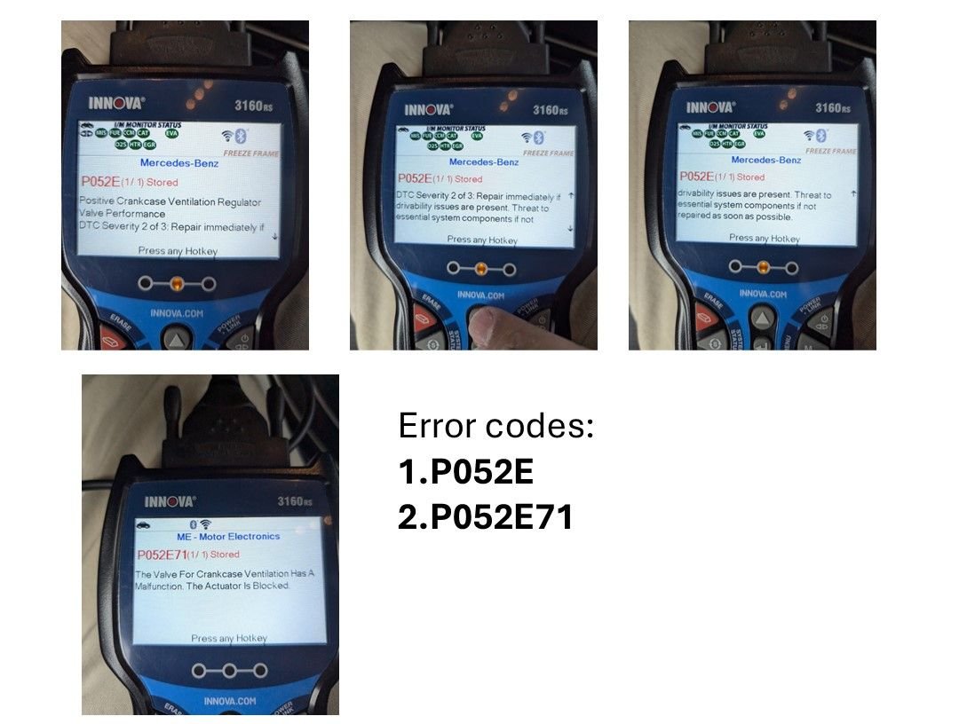

Hello,
I recently had a check engine light warning light up. My 2018 C300 4matic has roughly 23,000 kms. I unscrewed and tightened the gas cap as I read it might be an issue and drove a few kms.
The check engine light did not light up or cleared after a day of driving. Maybe around 80kms total. I’m just observing it now as it is the 2nd day that it has been cleared.
I did scan my car using a OBD2 scanner that I borrowed today, It showed code P052E71 and P052E as stored.
I’m unsure if the code I read was due to the engine light warning a few days ago, or if it was an old code that wasn't cleared ( Bought the vehicle 4 years ago as a Certified Pre-Owned )
Not sure if Canada now covers this. I saw the letter above the thread, I believe I got something like that but unsure if this is what it is for.
Given the code just cleared automatically after driving, do I just observe for now?
Or should I contact already the dealership and mention this, and also show the letter?

Hi Victor,
Did you get yours diagnosed and checked by the dealer?
All done and no issues?
My car recently had the check engine light on, but then it went off after a day of driving.
CODE P052E and CODE P052E71when I used my scanner.
I was just in contact with MB Canada and the response below in blue font.
It seems there should not be an issue to get it replaced.
