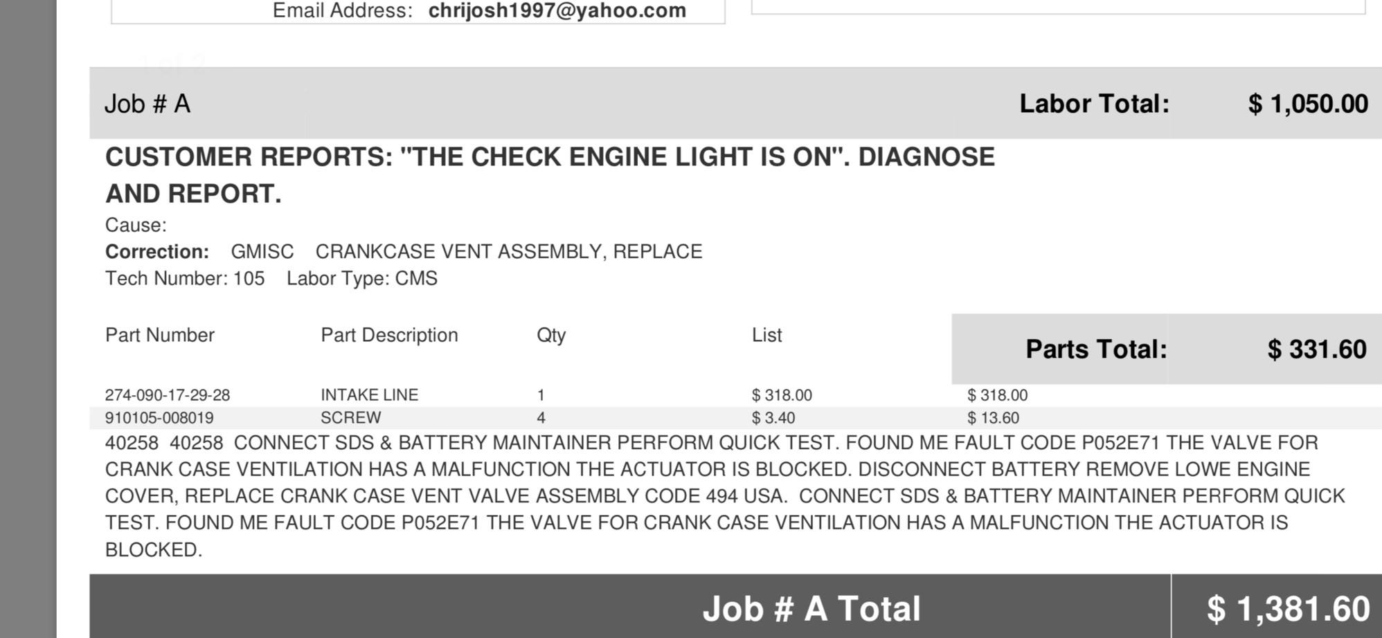

Had the same issue happen no more than 3-4 weeks ago. It’s in the lower engine assembly... if you are trying to do it yourself... don’t. Take it in. Cost of repairs were $1300 before my service warranty. It was a full day repair. About 8 hours on the lift

Thanks JChristjr5. Your info is very helpful. I already booked an appointment with MB dealer to check up since I still have 2 months of warranty. Hopefully they will cover it? I google the part number that you give me. I think it is the one in the picture (mark in red) but I am not 100% sure.

My post from a few months ago has everything you need: https://mbworld.org/forums/c-class-w...ode-p052e.html
I finally had my repair done last Friday. Took my indie mechanic 4 hours to complete the job. Parts cost me around $350 from my local MB dealer.
