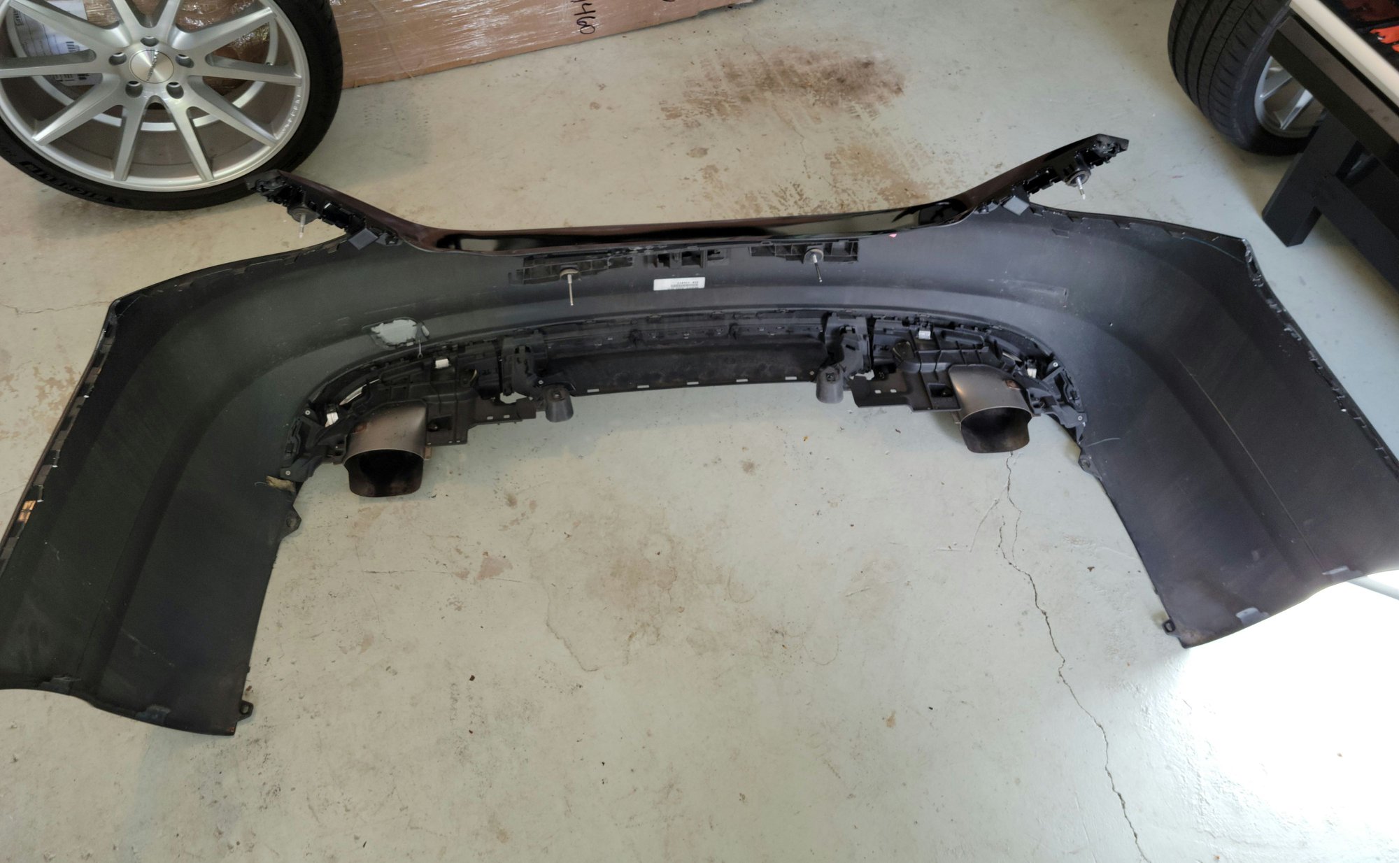

Originally Posted by Keith66
... The exhaust tips (C43/C63) are mounted to the body of the car and are an independent component from the bumper cover or diffuser. In other words, the bumper cover and diffuser come off the car in one piece, whereas the exhaust tips are bolted to the bracket which is bolted to the car...
After swapping rear bumpers myself, I need to correct my incorrect assumption above. The bumper, diffuser AND exhaust tips are all connected as one piece.
Everything came off as one:
All times are GMT -4. The time now is 03:21 AM.
