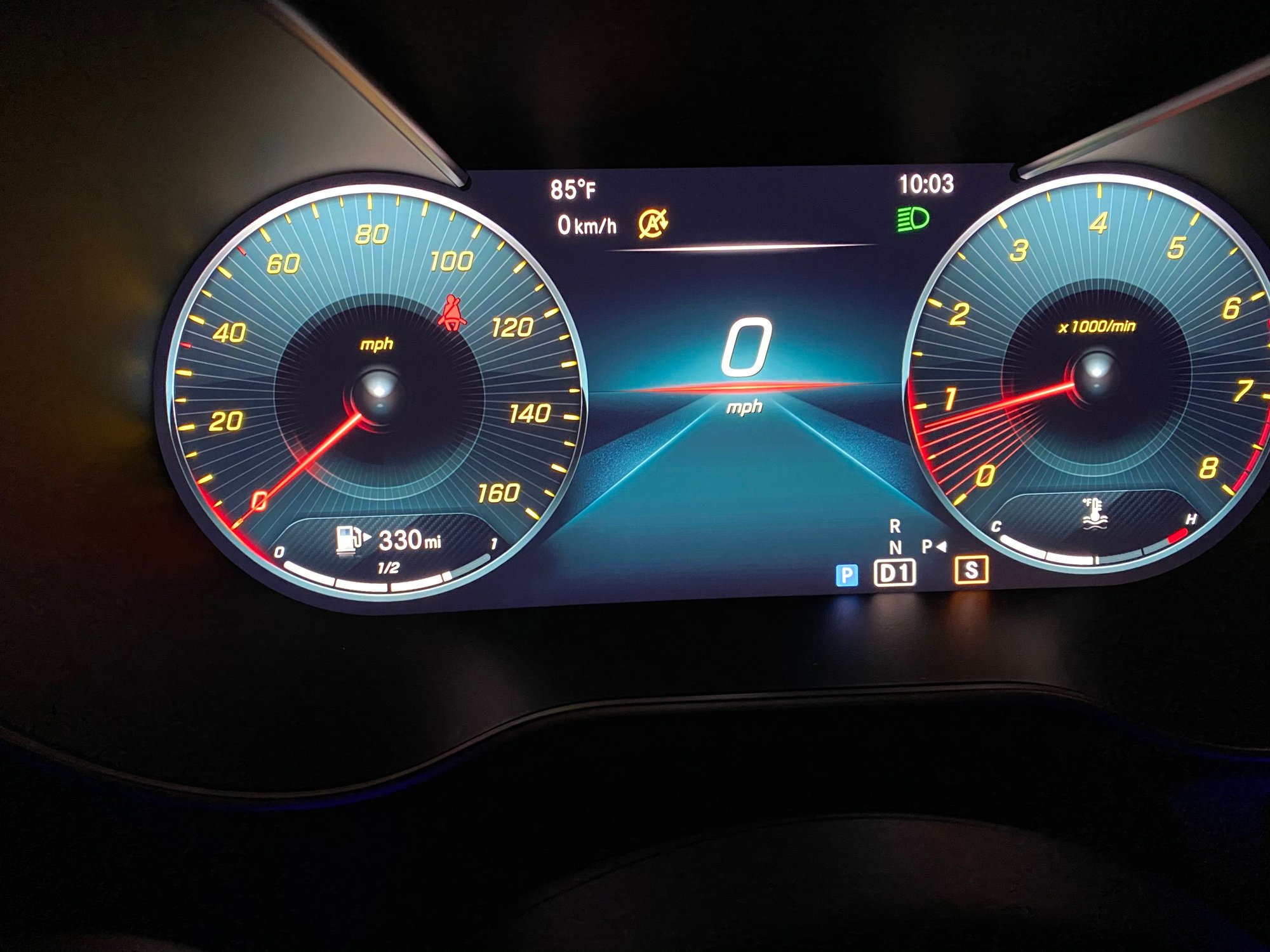

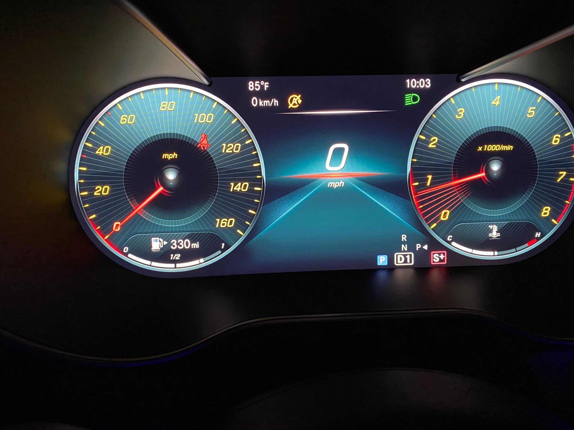

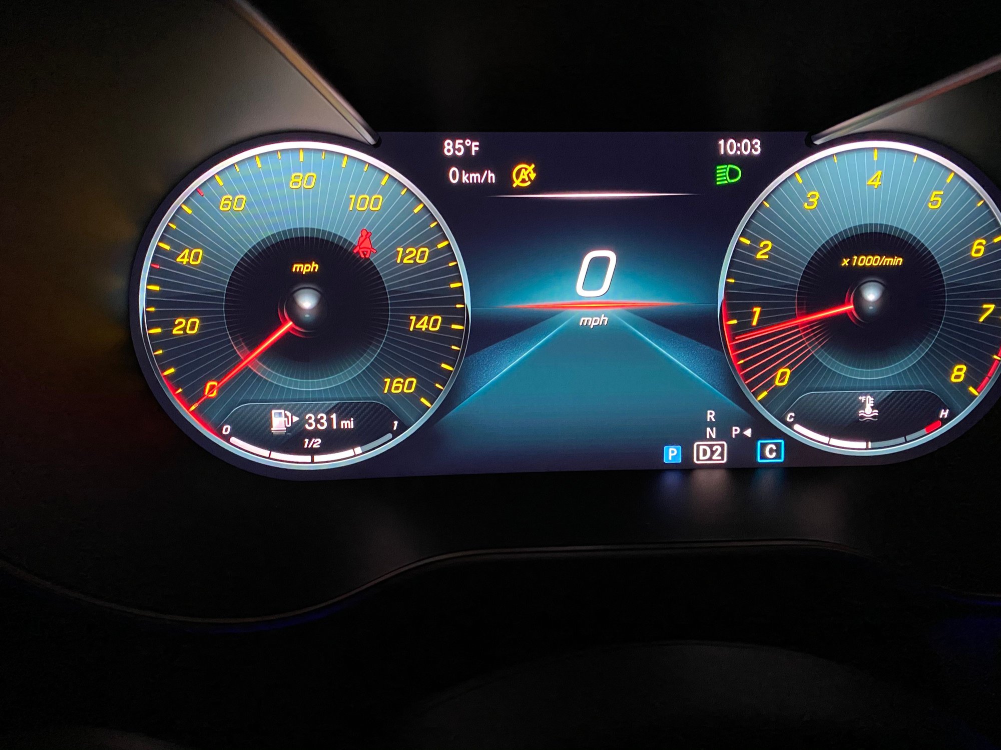

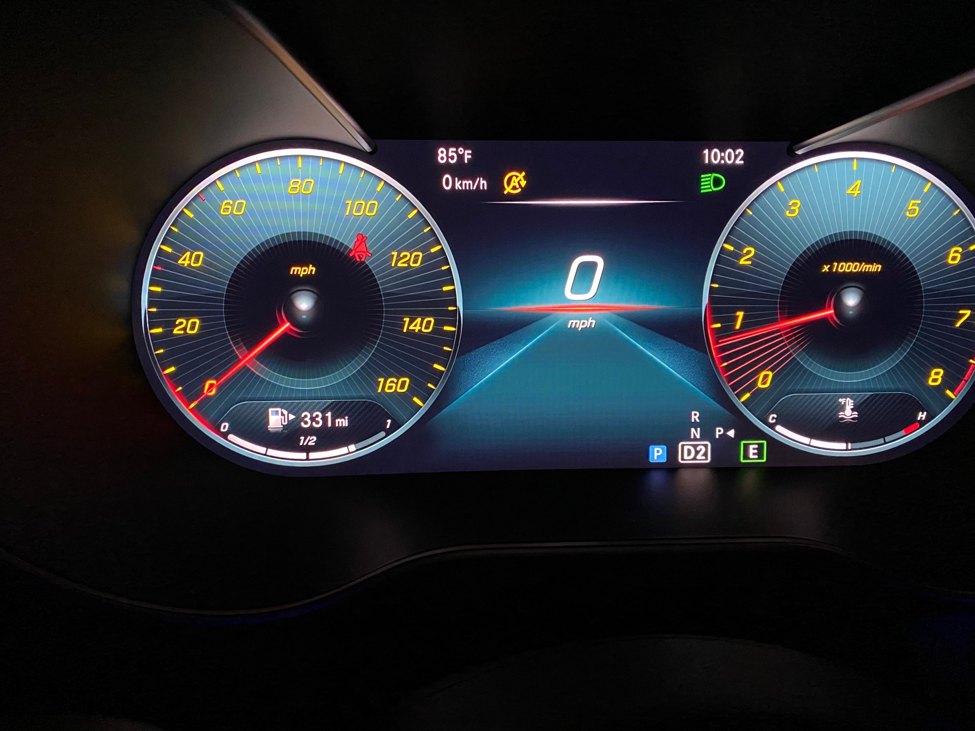

My car (2020 9-speed) definitely starts in second in Eco and Comfort and first in Sport and Sport+.

That's because the car we're talking about is a 2016 which is a 7 speed, completely different transmission which always starts in 1st.

I am so envious of the digital dash
