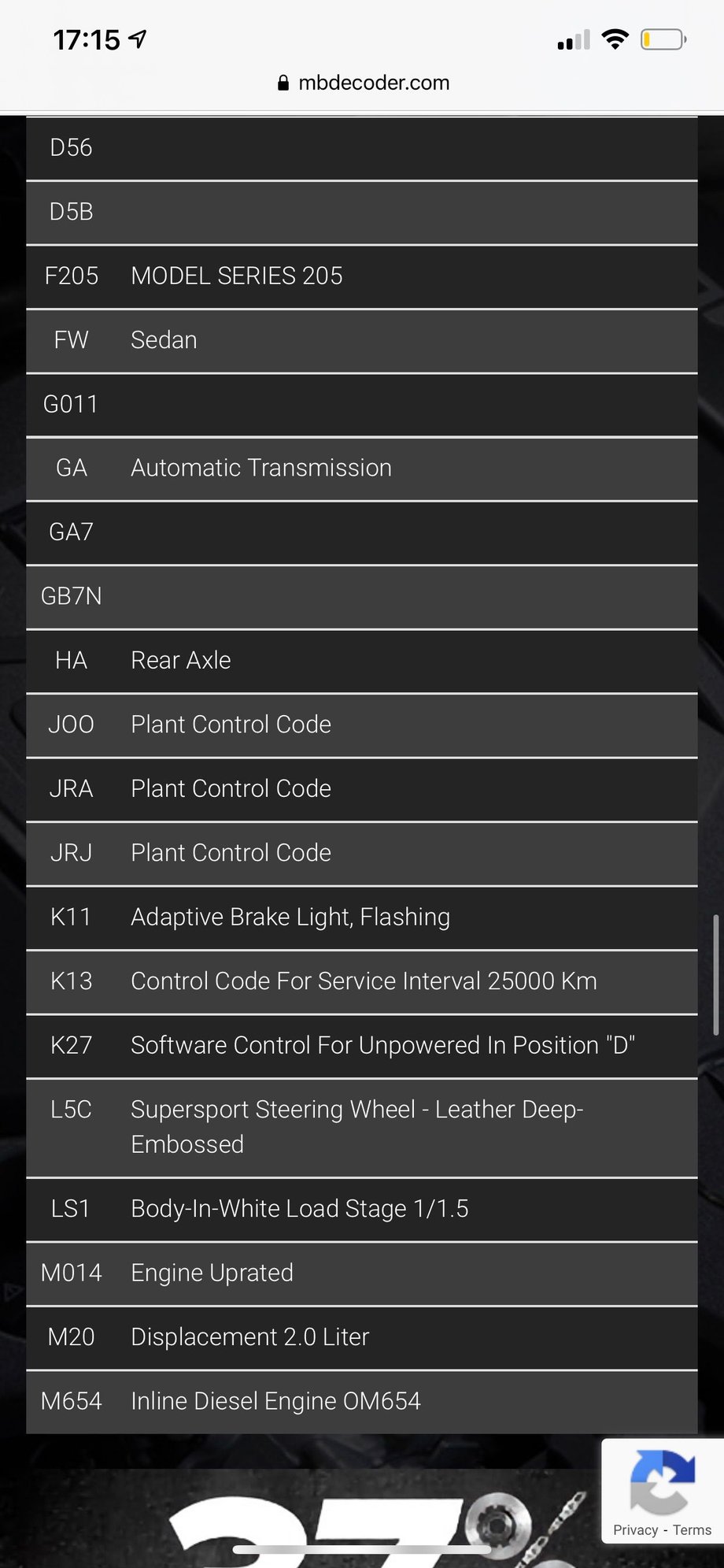

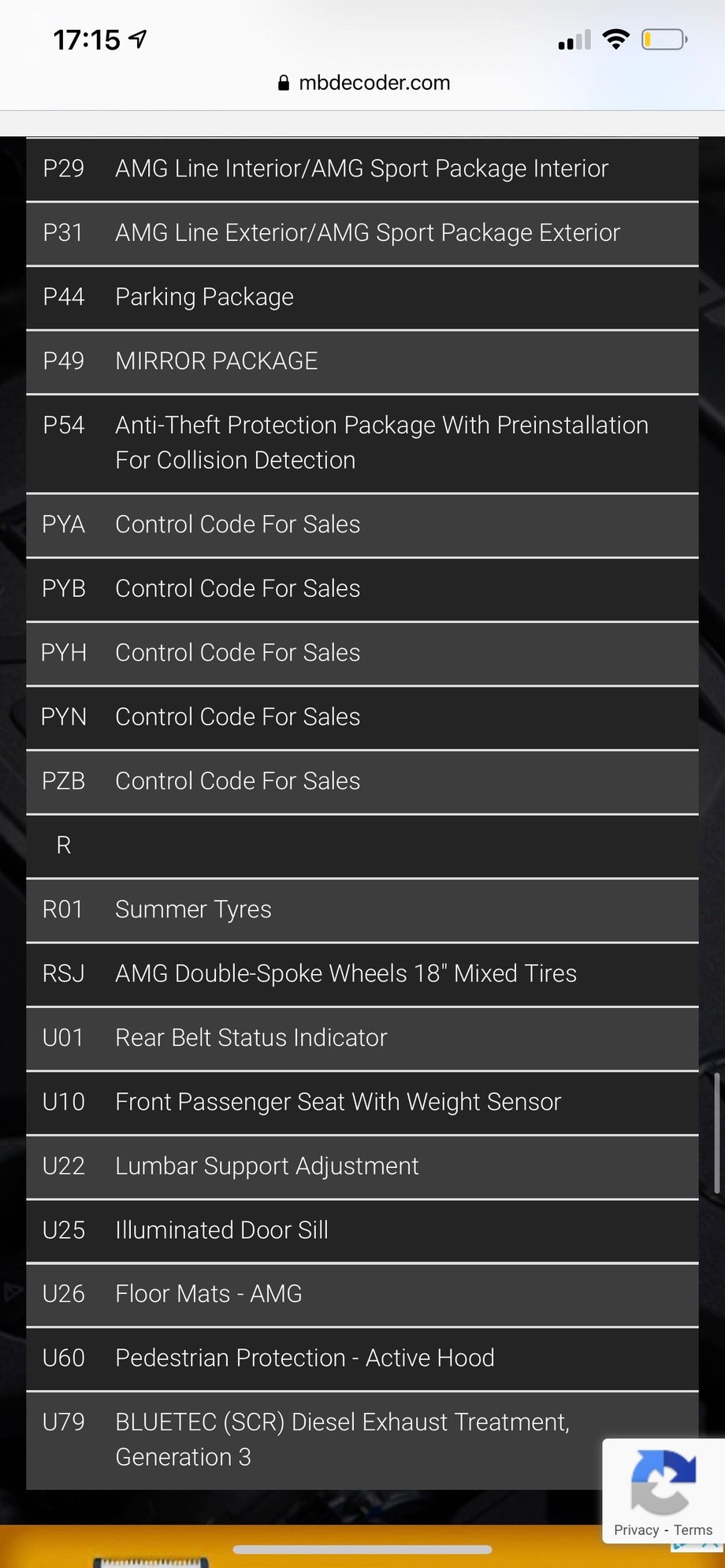

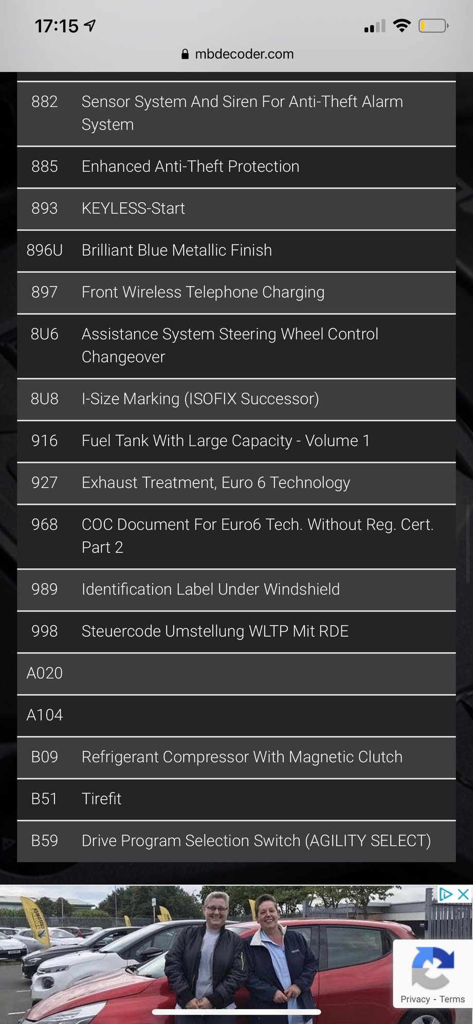

Hi.
my w205 has all the driver assist, active brake, radar sensor and the 2 stereo Cameras but Dosent have the DISTRONIC?
how easy would it be to retrofit. it looks like a matter of code to my un trained eye.
Mine is a 69 reg AMG line premium with the digital odometer. If it’s a case of a few parts and some coding I’d really like to go for it.
see the full spec below.
