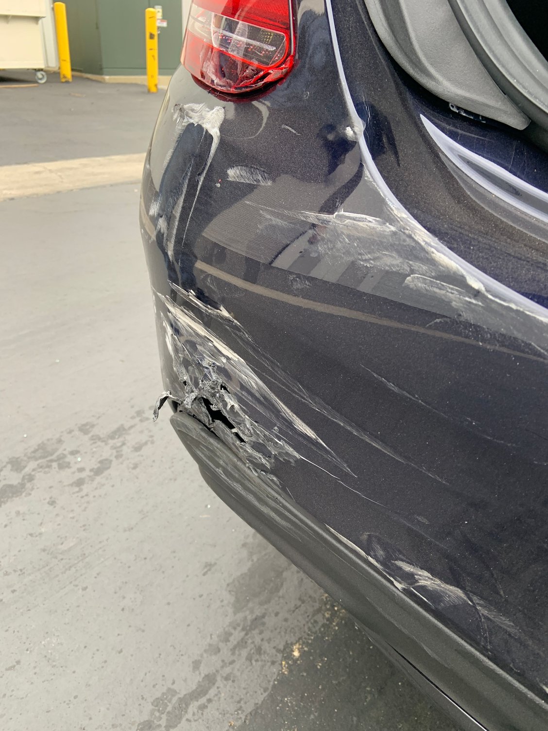

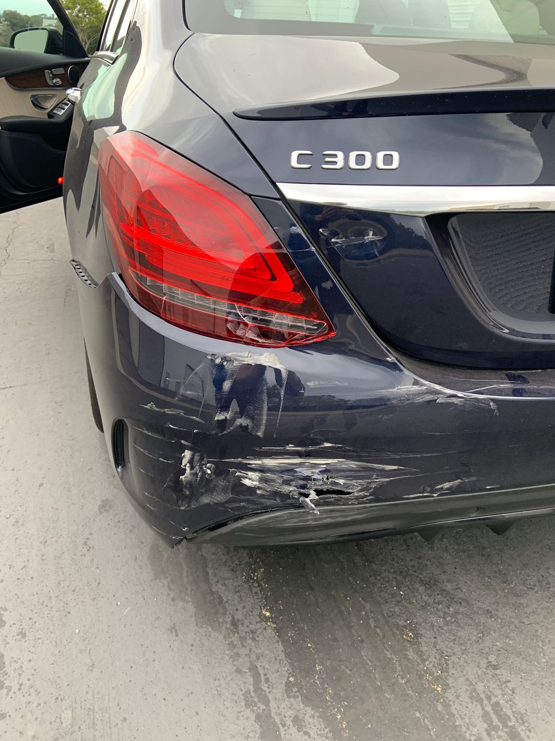

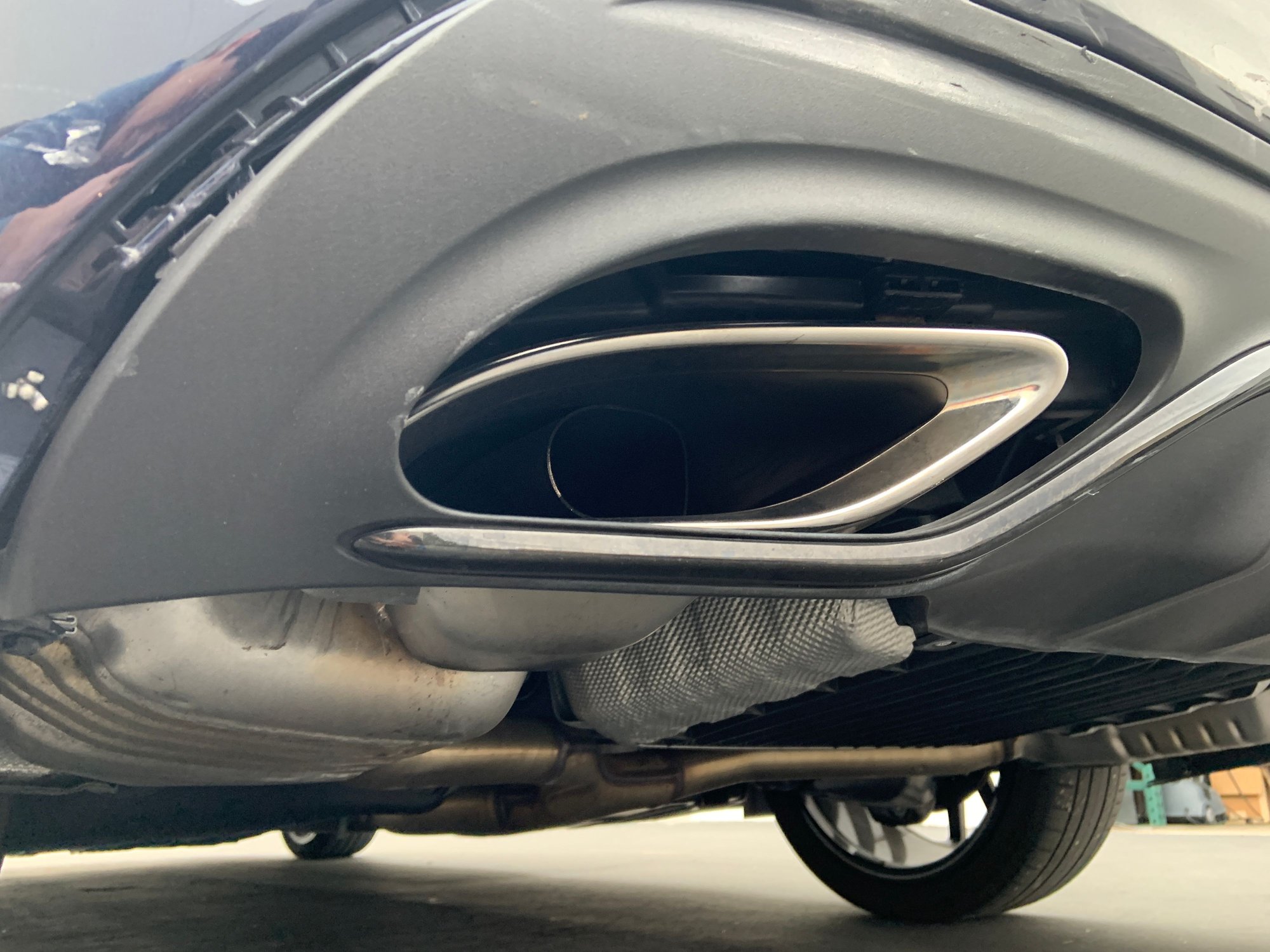

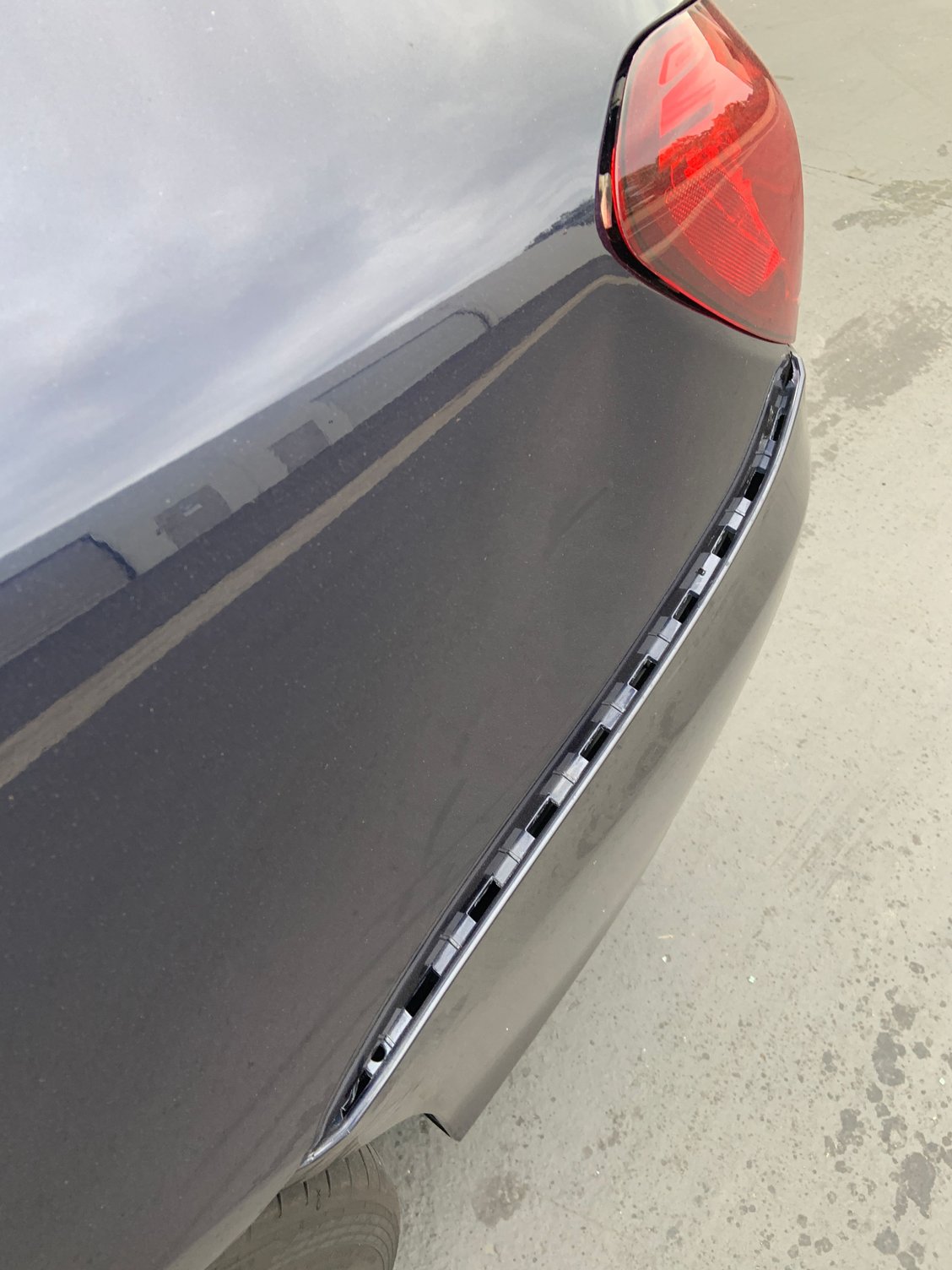

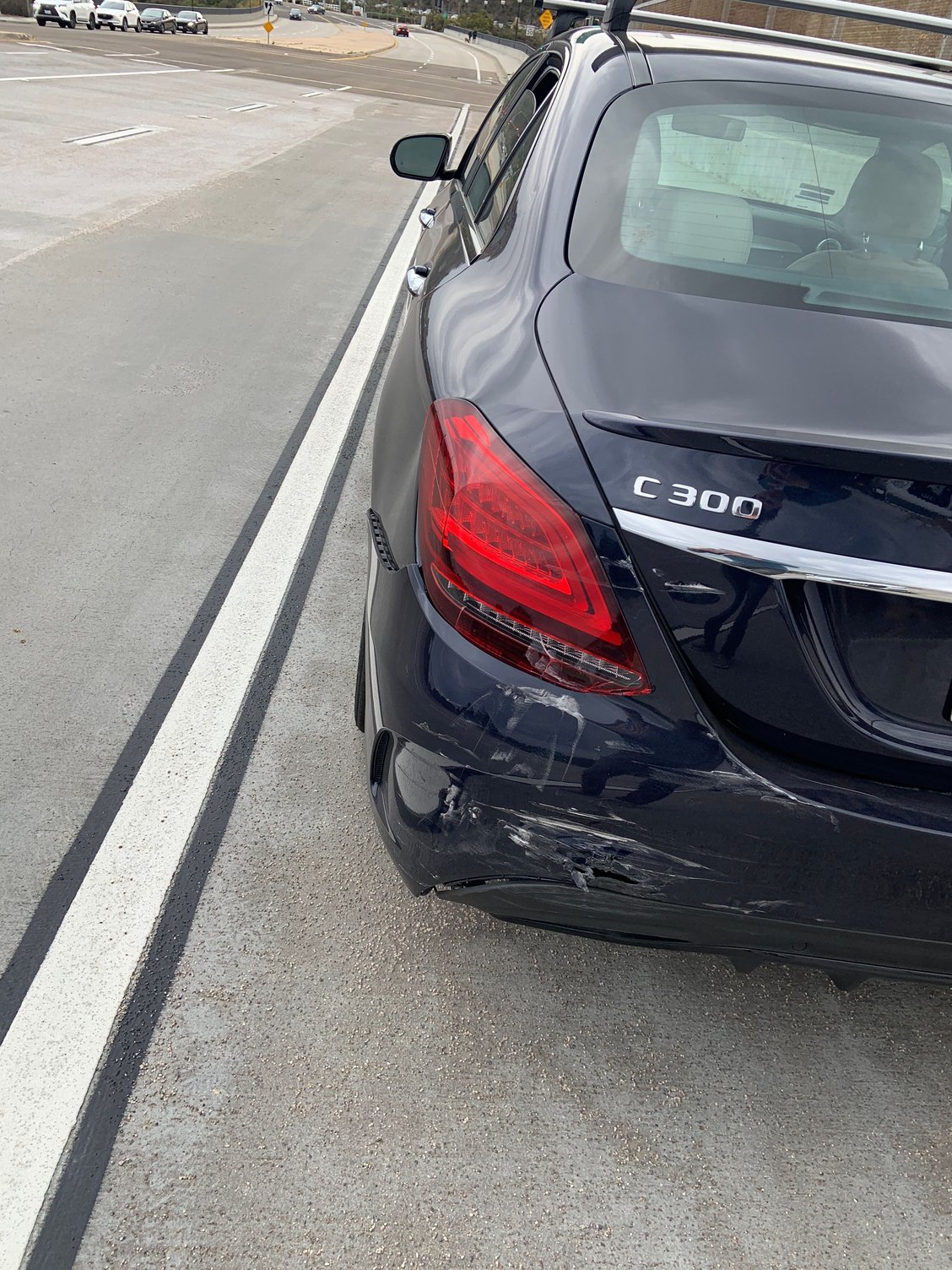

Well, just over two weeks after I picked up the car I was rear ended pretty hard. The plates for the car didn’t even arrive yet. Long story short, there was a red light ahead and I was kind of slowing down to it and the guy behind me was going much faster and not paying attention and bam. He was doing about 25 mph faster than I was. He took responsibility for the accident of course, but man this just sucks. It happened last Tuesday but I waited until everything was cleared up with insurance to post about it.
The car did really well, I had a front seat passenger with me and the front seat belts blew and locked up, so did the rears weirdly, but Mercedes said that was normal. After the accident I got a call from the Mercedes sos services asking if I was ok and if the cops or paramedics needed to come out, that was a nice touch.
Looks like I’ll need a new bumper, taillight, “diffuser”, repair the trunk and the bent quarter, plus new seatbelts all around. Car was drivable after the accident obviously, but just drove it and parked it because of the blown seatbelts. Everyone involved in the accident was fine. It wasn’t a massive crash but it wasn’t a fender bender.

Usually here if seatbelts are deployed in a car and it has frame damage they total them, looking at your pictures the kink in your 1/4 panel could indicate the possibility of frame damage, just by the tear in the bumper cover you can see it was a decent hit as these bumpers take a good knock and dont tear up
Just incase they repair your car, check your seats where the seatbelts have pulled tight, as I have had 2 cars that the rear seatbelts have deployed in and the seatbelt dragging over the leather so fast it had caused marks in the leather, they needed retrimming or replacing, the seatbelt also cut the fabric on the rear pillar trim where it pulled tight.
Also had 1 front seatbelt that caused the lower centre pillar trim to snap the lugs off the trim and it would not clip back in properly, also was replaced.
With any rear ender, check for water leaks in the boot area

The body shop said they wouldn’t be surprised if there is frame damage, they said they’d know more on Tuesday. The hole in the bumper is big enough to see the crash bar and it looks like it missed it, but the body shop thinks it was actually pushed to the side and created frame damage.
As for the rear seatbelts the buckle is so tight into the bolster that it’s probably going to leave a dent in it, I’ll also definitely look to see if there are marks as well. I forgot to mention that the rear seat belts pulled my rear headliner down and broke the plastic piece that goes around the seatbelt where it pokes through the headliner.
I personally doubt it will get totaled even with frame damage because the damage doesn’t look too extensive.

Quick update, the estimate came in just over 11k, no frame damage, and it’s not totaled. But will take a month and a half to complete.
