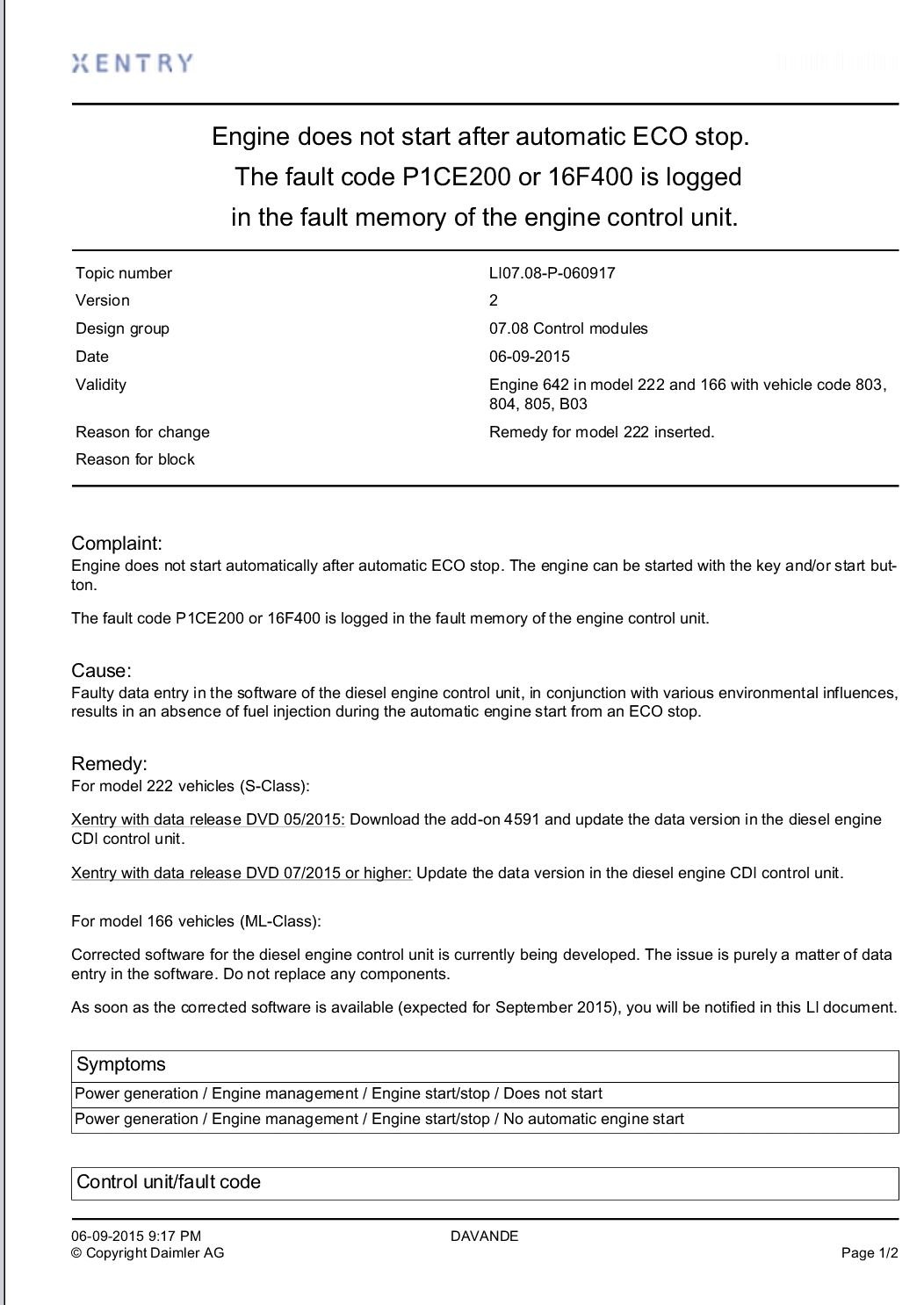

Old May 29, 2021 | 03:41 PM
CaliBenzDriver's Avatar
Joined: Apr 2019
Posts: 11,919
Likes: 6,769
From: Silicon Valley
W212 MY'14 M276-3.5NA @75kMi
how about this fix...
ECU SOFTWARE BUG...
Old May 29, 2021 | 04:30 PM
MBenzOwner's Avatar
Joined: Mar 2021
Posts: 63
Likes: 24
C300
I looked at this TSB but there are for diesel engine versions. That was the rationale behind taking to the dealer to see if there is a software update needed but they told me all the software is up to date. Is there a way to check this if you can get the control unit info to verify what they said? Like the latest firmware/drivers for computers?
They mentioned that they opened a PTSS case w/ Germany but got back that would need 6-15 hrs of diagnostics time with no assurance of a resolution or diagnosis. This is not practical / too costly for an out-of-warranty car. I already paid for them to do 5-6 hrs of diag but didn't get an accurate diagnosis so I was turned off at just throwing more money just to diagnose the issue. I wonder how much work they really did. I'm sure they wasted time checking tire threads, brake pad thickness, and other nonsense. I didn't get the sense they would truly help get to the bottom of it without spending 1-2k on diagnostics since it was out of warranty and they can't bill Mercedes. That was also before any repair on the car.
They also mentioned once on a PTSS case, they were told to change the engine or Germany needed to write a custom software update. I'm not sure this would again be practical for a 2015 car out of warranty. Also given that a lot of cars don't have this issue makes it seem that it is not a common occurrence which would be more likely if it is a software bug.
Here are some TSBs that are similar but again they are all software issues.
