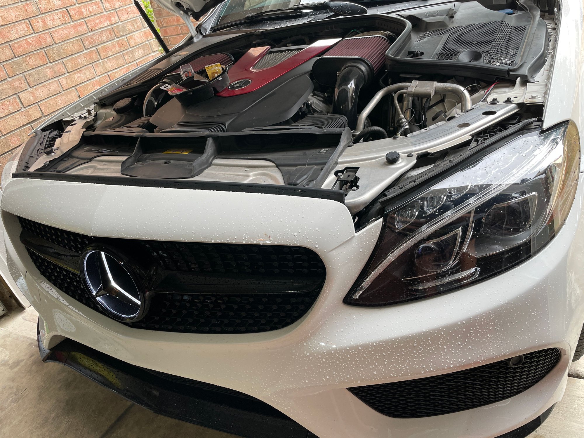

I finally got around to wiring the illuminated star in. I love the look!
I ended up using a OEM star and a OEM harness.
The harness was great for the plug end to the star, the other end was useless. Had to cut it and tap into the fuse block.
Now mine is like yours, always on when the car is on. I used F123.
But would love to know if there is any fuse that I can tap into so its on only when the headlights are on. Not all the time.
