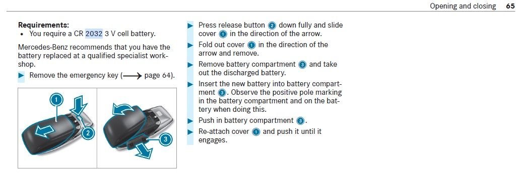

Why are you putting a CR 2025 in the key fob? The key fob explicitly requires a CR 2032 battery.

Not sure if the PFL key fob type perhaps used a CR 2025, but it's pretty clear in the owners manual for the FL.

Ah yeah, there it is. PFL uses a CR 2025. OP, what year is your car?
