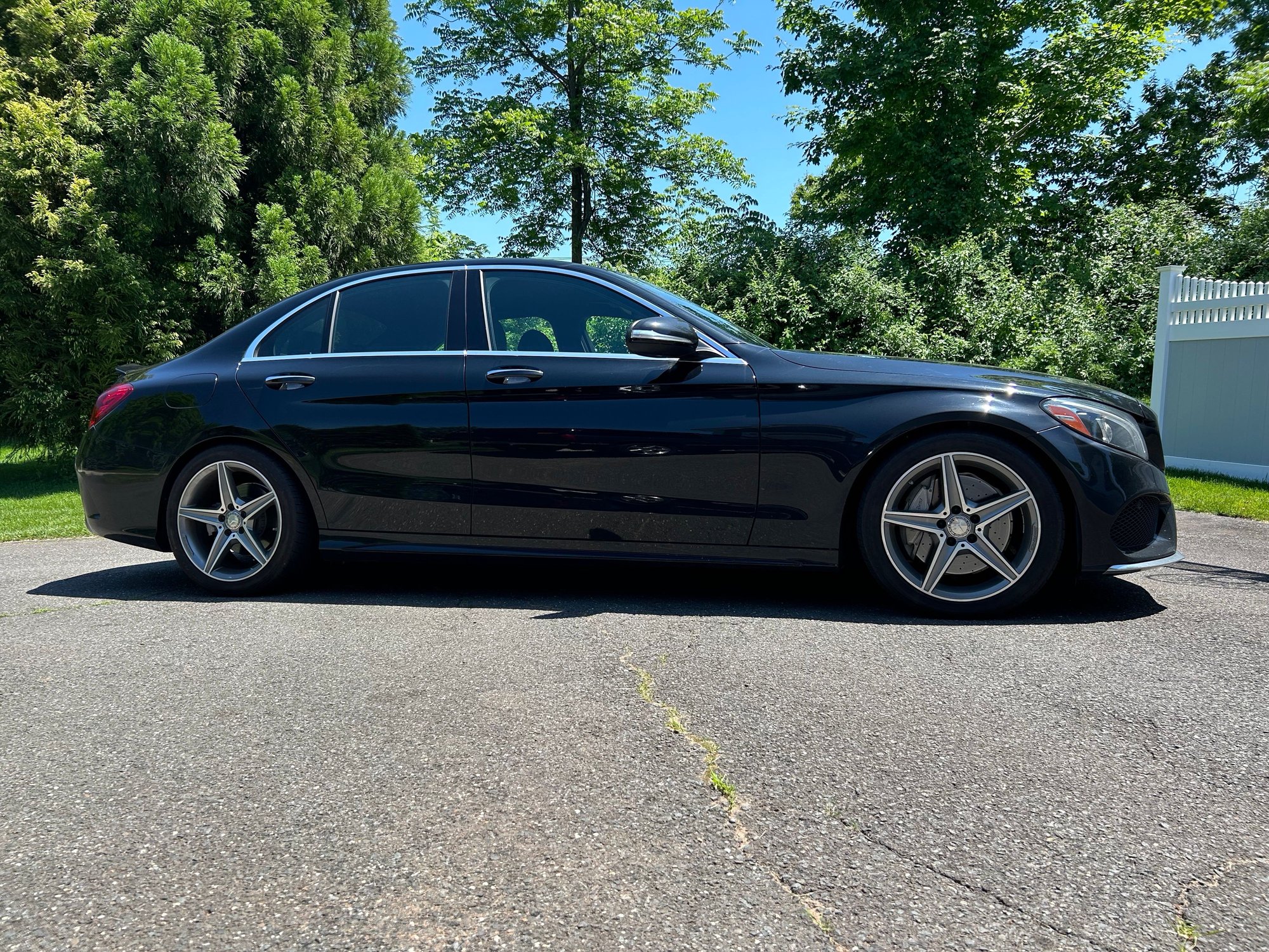

Hey. Congrats on picking up a C400. I love mine. Install went fine, and the drop and handling is great. I installed on the stock struts.
My only complaint is the front sits a bit higher than the rear. I was aware this was an issue with the H&R springs, but not the Eibachs. Ironically, a few fellow former members shared their foreshadowing experiences with ride height above.
I’m wondering if I swap the struts to Bilsteins if maybe the perch is a bit lower. Still debating.
For the cost, I’m very happy with the look and improved handling. The ride actually feels less rough, but also tighter.
I’ll post some pics soon.
