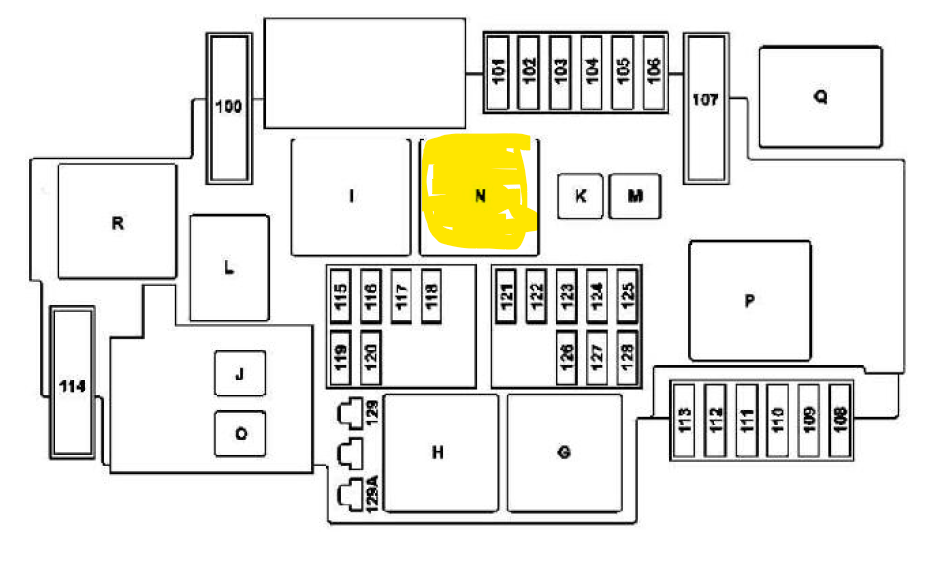

Try replacing the Circuit 87 Relay, this is located in the engine bay fuse box. See picture below.
My friend's C had very similar issues... multiple codes relating to circuitry; either high or low or open.
Eventually after months of troubleshooting and hardware replacement, we solved it with the replacement of this relay.
This may/may not work for you, but it's not an expensive part to replace so its up to you to give it a try.

i have attached the Fuse box diagram as well for your reference and further troubleshooting.
