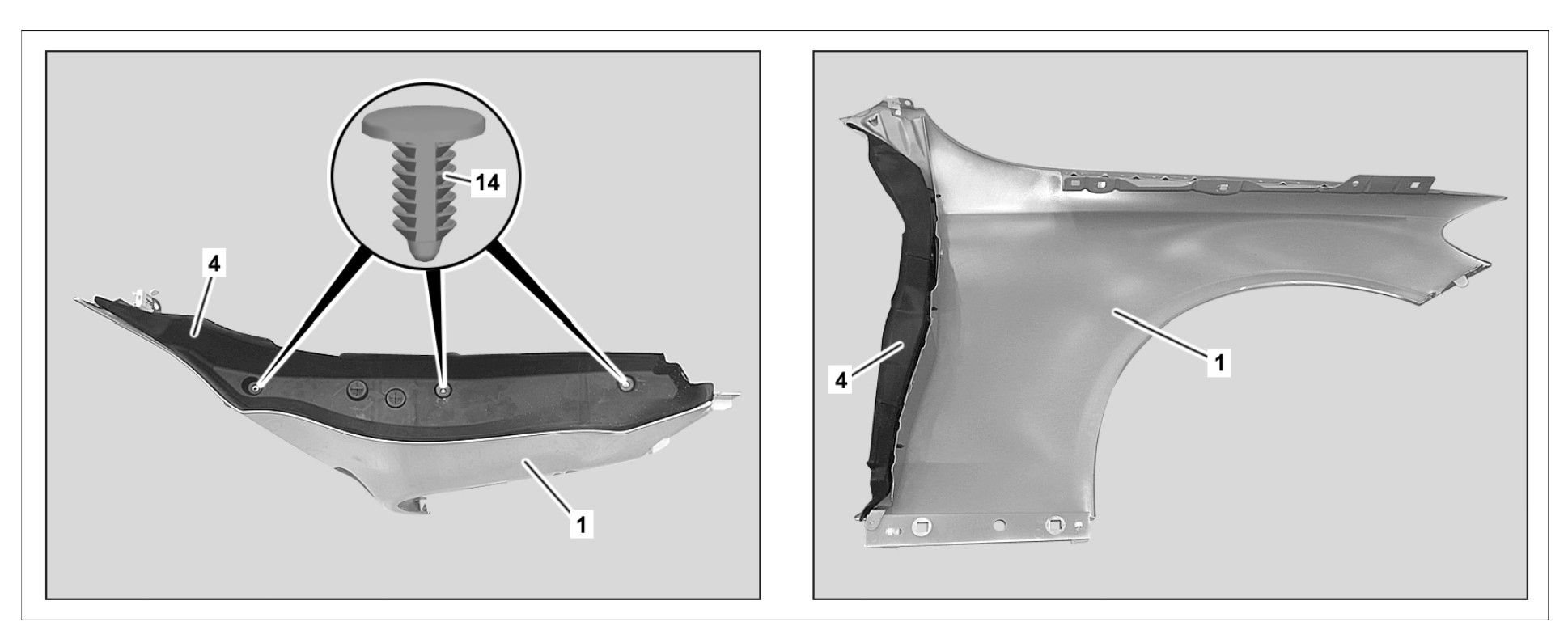

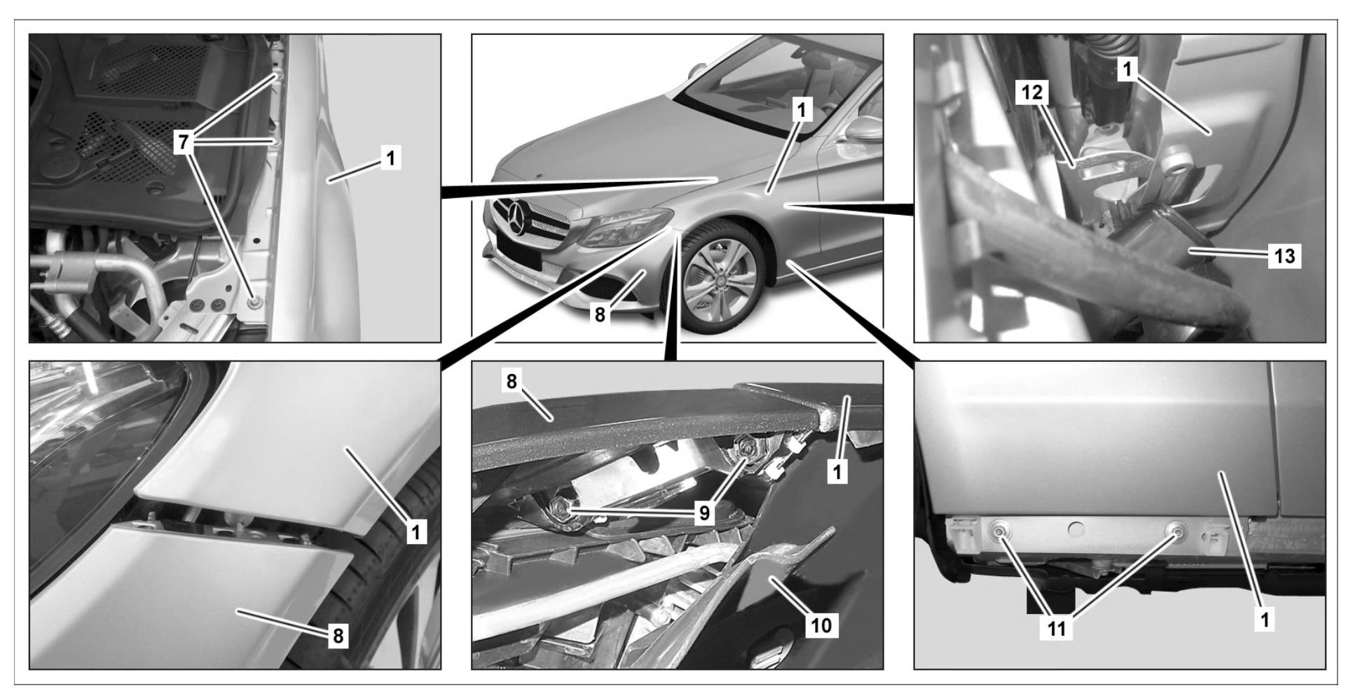

To remove the fender - Left side shown = Same on the Right Side
Don't forget that you also have to remove the fender liner.
I hope this helps.

is #6 a Torx or hex ? I had assumed it would be Torx

Not sure as I have never removed the fender but it's called a screw and a bolt. It states to remove the bolt.. it's also the adjustment bolt/screw for when it's being installed to help adjust the fender. Use your phone if possible to zoom into see what kinds of screw/bolt it is.

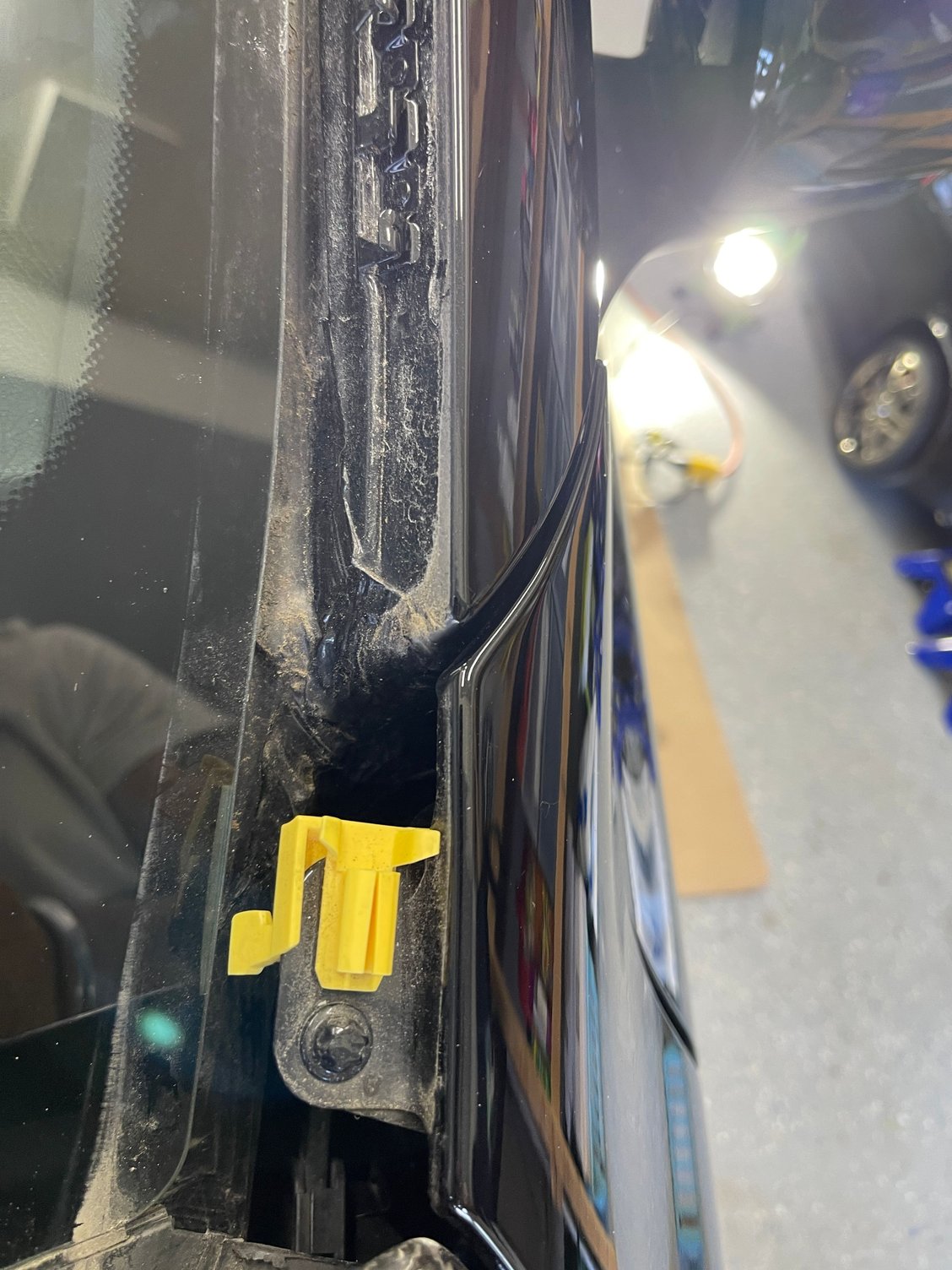

so going by the pictures above ;
#2 is a T8 bolt... bottom corner of windscreen. to remove the trim, basically get good grip with fingers slightly tucked under rubber pull straight up with a slight rotation towards glass. probably not the correct way to do this but worked for me
# 5 is a 10mm and #6 is a T20 ..... passenger side only has the 10mm bolt.
#7 #9 #11 are 10mm there's also some plastic push pins

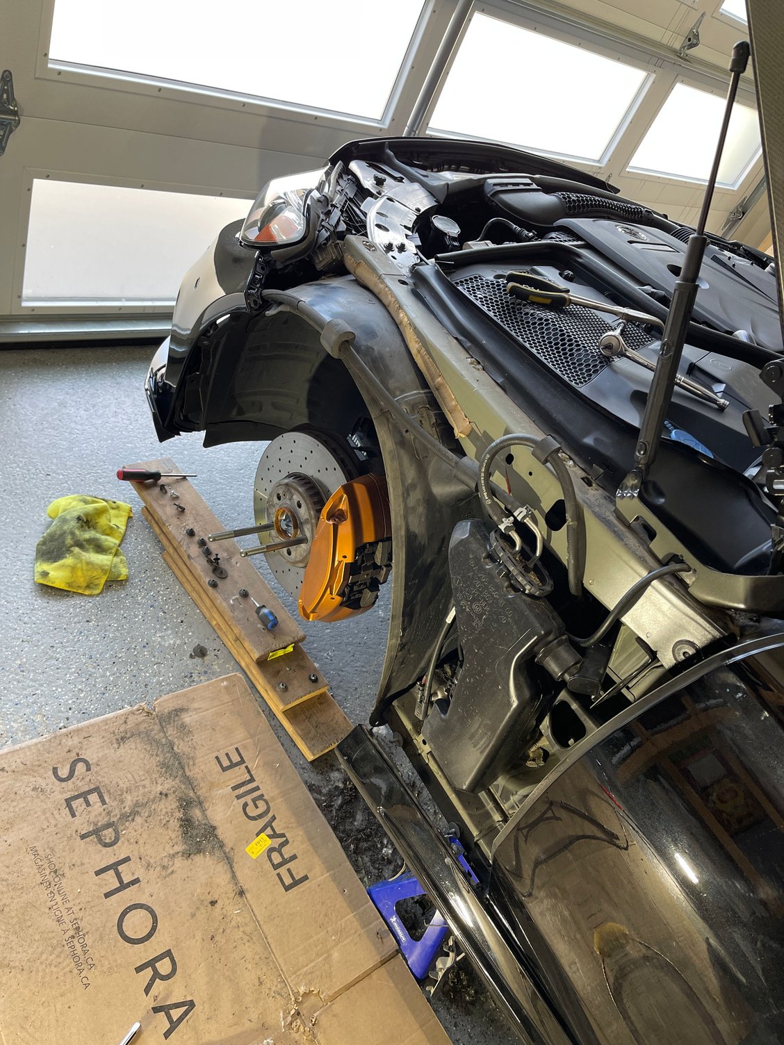

No need to remove fender liners, for second side I just removed some fasteners to get some working space, same goes for the plastic pieces on the inside of fender and door don't need to be removed so don't wast ur time trying to get the stupid clips out. #14
I didn't fully remove the rockers just undid the first couple of 10mm nuts and flat disk looking things, then just pulled the rocker out towards myself. open door and pry the rocker out of the first two clips holding it on the inside. This definitely not the correct way to do this as I'm pretty sure the two inside clips are not right when I reinstalled everything. it seems like the clips need to be taken out of body and installed on to rocker and then pushed back but it's holding secure and looks fine.

Glad you finally got them off. I think the yellow clips maybe used to help with alignment before all the tightening.
