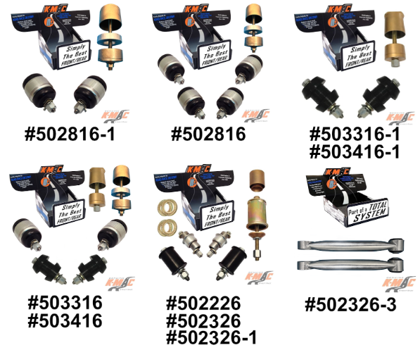

Yes cost cutting and ever increasing speed of new car assembly lines Front Camber (and Caster) along with rear Camber has been deleted !
Often quoted re assuring “Full Front & Rear ‘4’ Wheel Alignment” - is now only basic Toe “directional” adjustment.
Yet Camber is essential allowing to adjust tire contact angles to spread load more evenly.
Daily commuting encountering high cambered roads with excess passenger side edge wear. Or inner edge wear both sides through extra passenger loads or lowering. Spirited driving and excess outer edge wear. Plus now no ongoing adjustment to cater for curb knock damage.
K-MAC front and rear kits are designed to BOLT-ON - no special tools or need for time consuming control arm removal.
ALSO SAME TIME REPLACING THE 4 FRONT AND REAR HIGHEST WEARING BUSHINGS. WHILE RE INSTATING CASTER ADJUSTMENT ALLOWS TO RESOLVE STEERING PULL, IMPROVE DIRECTIONAL CONTROL, ACCURATELY COMPENSATE FOR CAMBER CHANGE !
Unique patented design allows precise single wrench easily accessible adjustment. ULTIMATE - direct on alignment rack UNDER LOAD.
PRICED RIGHT - FRONT CAMBER KIT (For Both Sides) $345 - less cost than one quality tire.
SEE SPOILER W205 Front & Rear kits (All Models)
Spoiler
AUDI to VOLVO - K-MAC Experience Of Resolving OEM Suspension Shortcomings (and Costs) Since 1964 !
