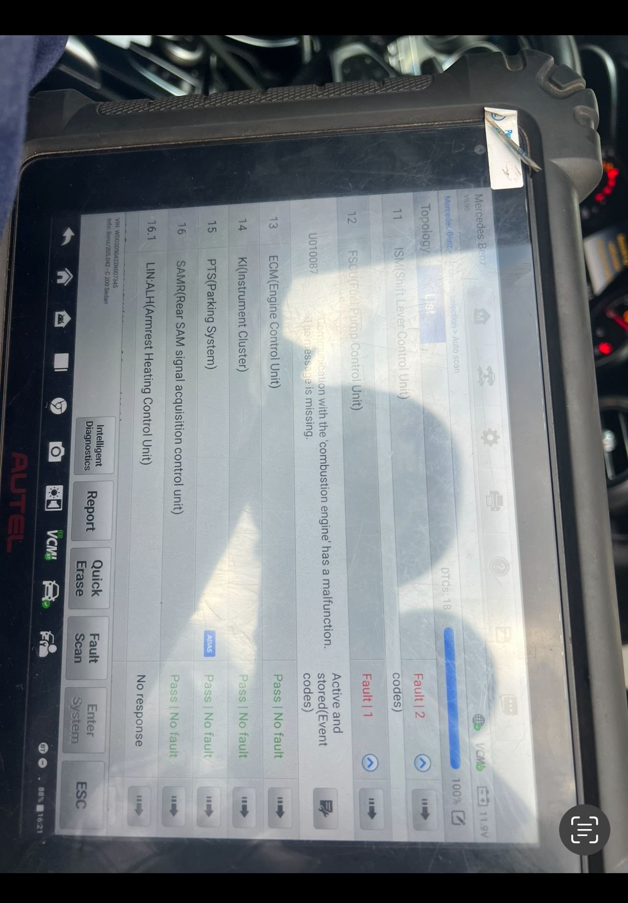

Hi there,
I have a C200 W205 which i have used for some time. Some weeks ago after driving it for some days after a service i noted that that the car was not cranking. The dashboard is powering on with all the accessories powering on but it cant crank. From the diagonasis as attached i note that there is module which the signal is not stable. Anyone who has had this issue? Tried to supply the power direct to the starter, the car seems to crack but it cant start

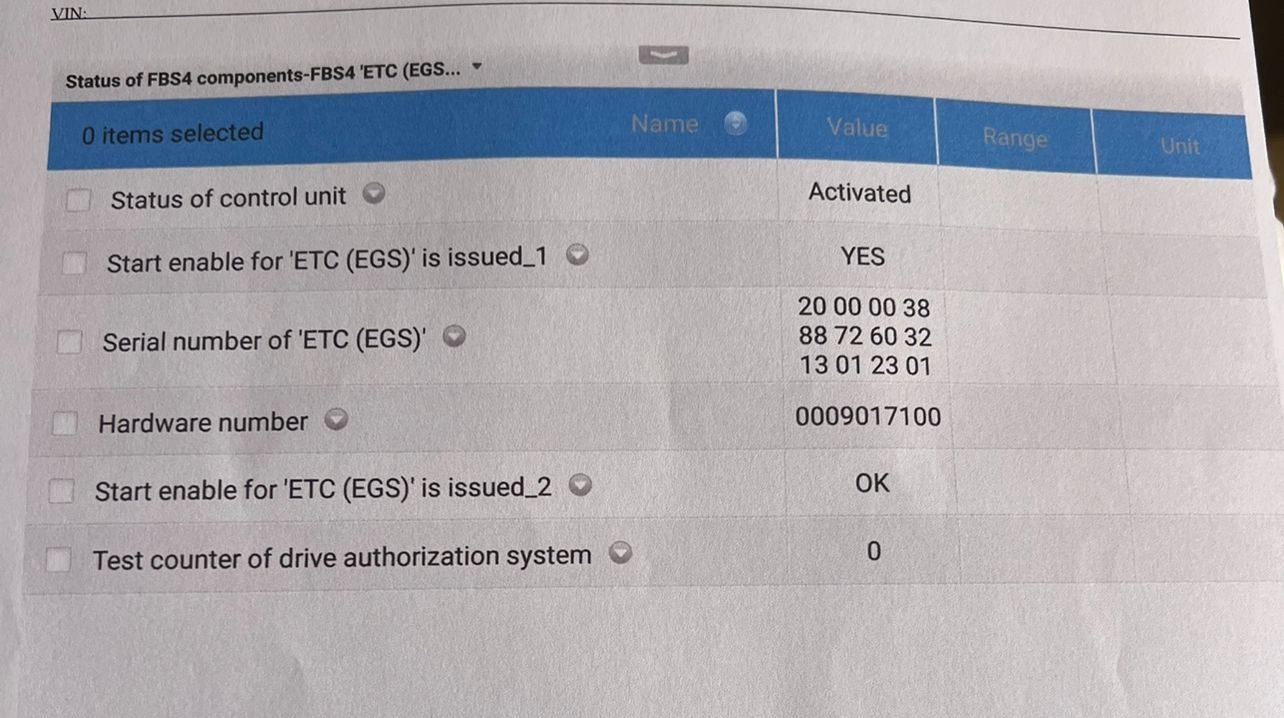

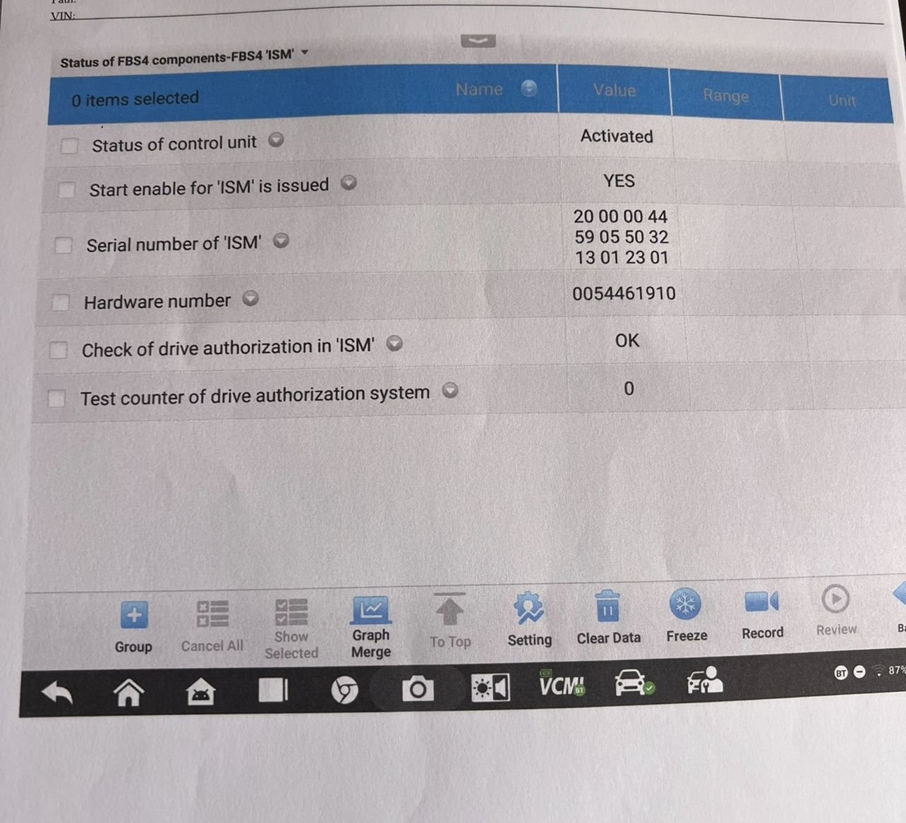

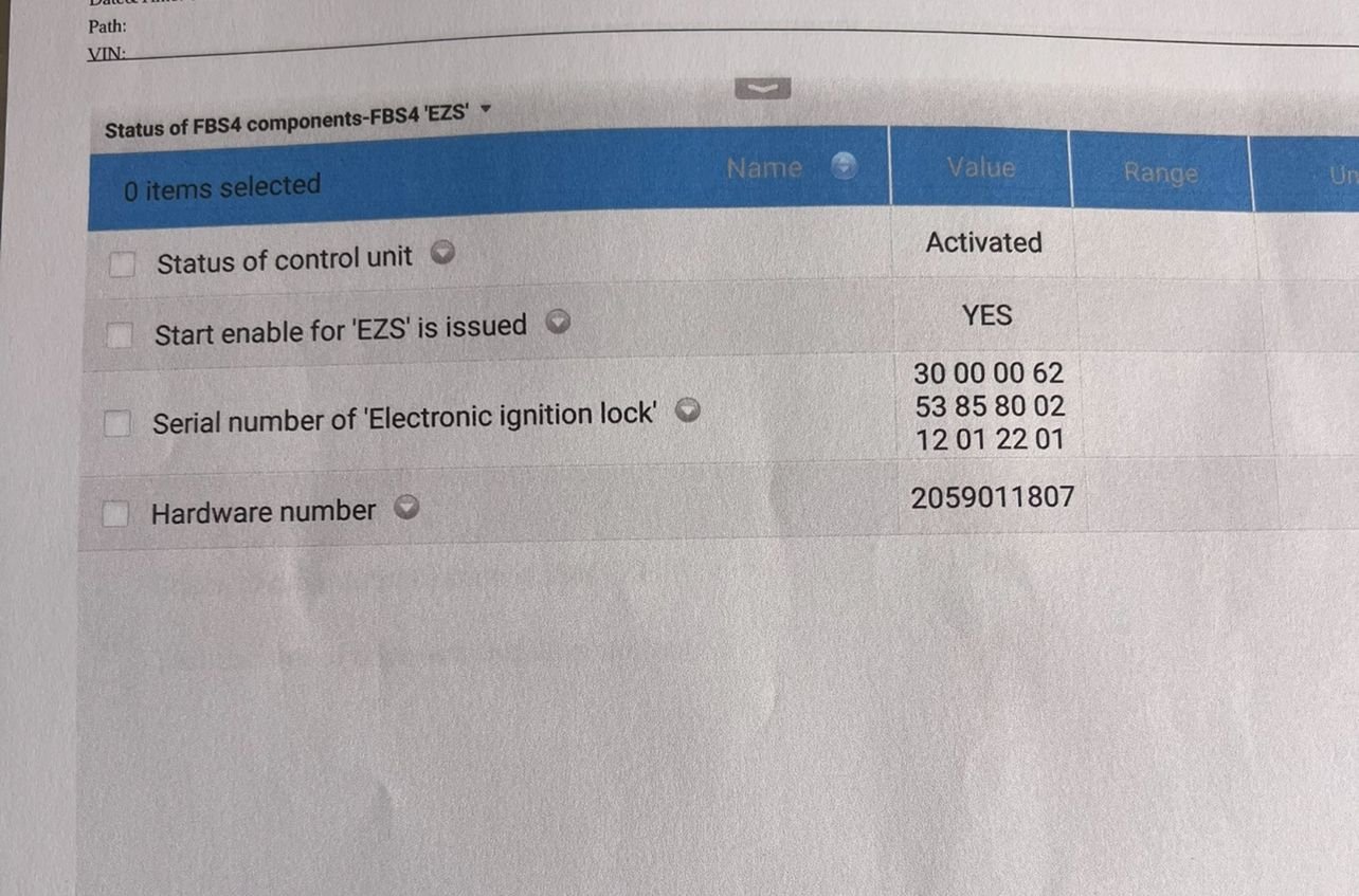

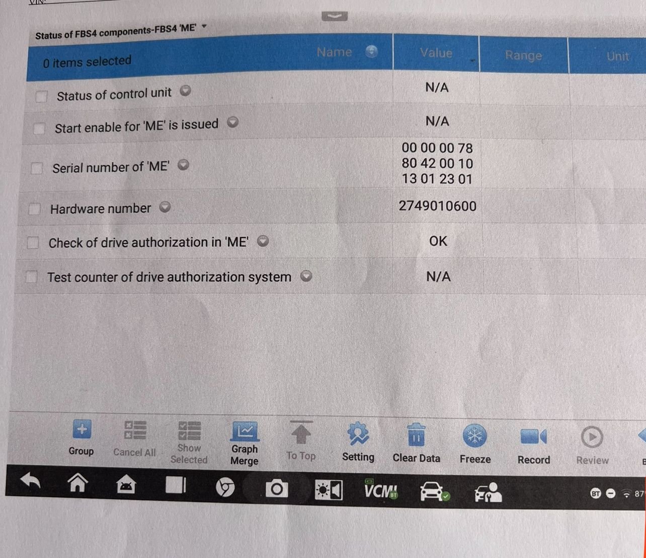

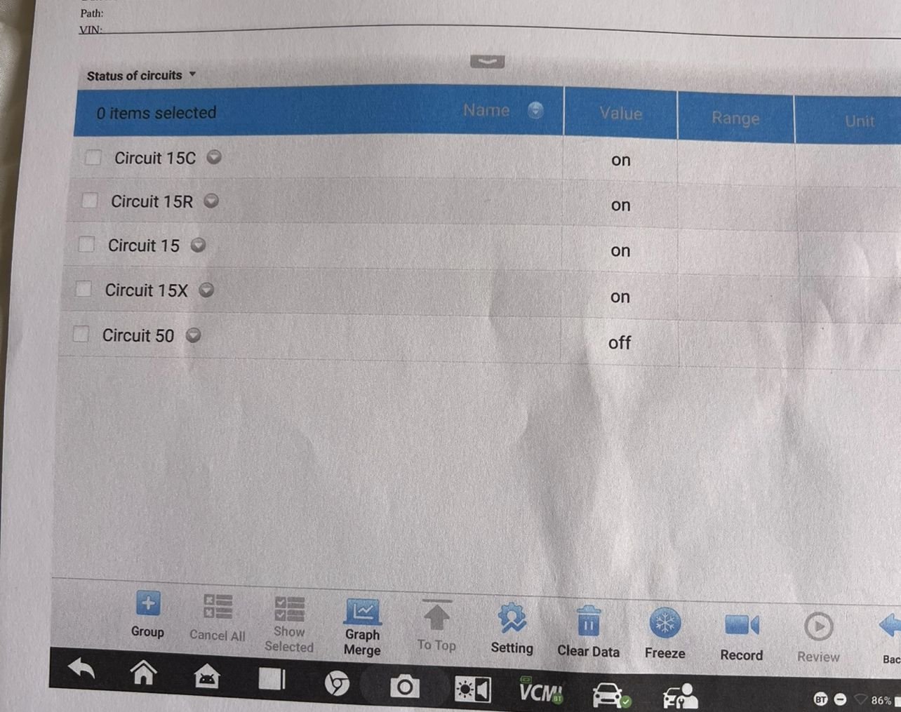

The screenshots shows what am getting from the diagonosis

WHAT are your 2x ISM Faults ??
This may well be it!
ECU must know gear status to allow start.
