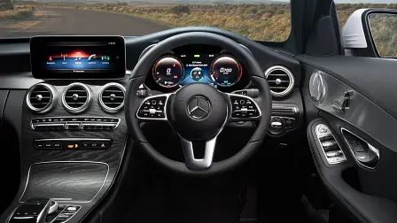

Is there a way to upgrade my MBUX system
This is what I currently have
Mercedes-Benz C-Class 2019

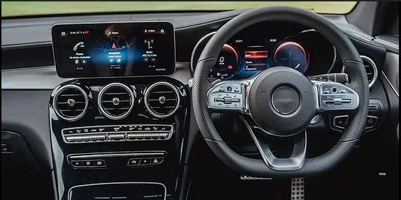

This is what I want

You have COMAND 5.5 for a W205 facelift. MBUX 1.0 as you show needs new hardware.
