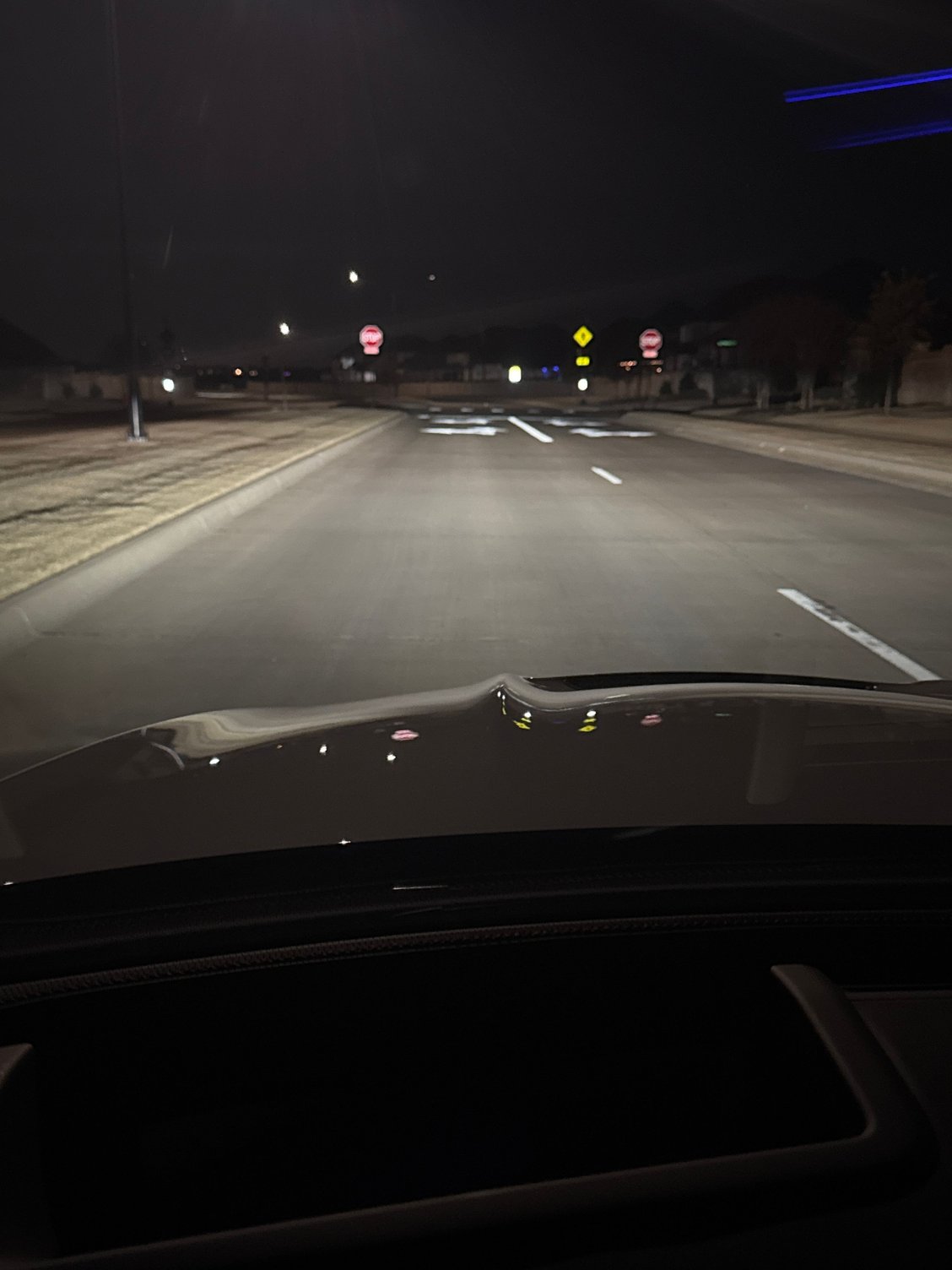

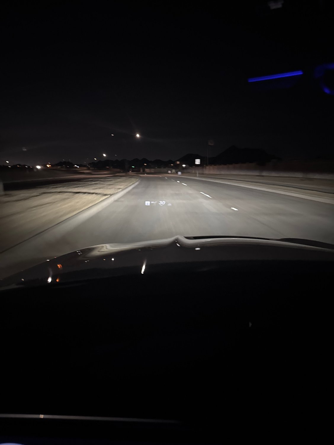

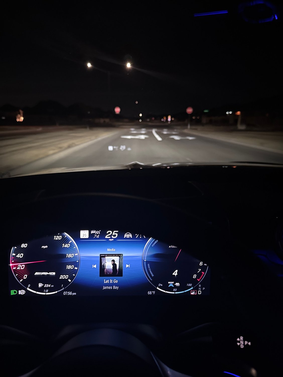

I guess in the manual it says those dots on the ground/asphalt is for lane keeping. No clue if that’s accurate however they raised the headlights today at the dealership. Let’s see how it looks.
Old Feb 25, 2025 | 08:41 PM
  #62
Ozabani's Avatar
Joined: Nov 2017
Posts: 37
Likes: 8
C300 Lux package + Driver assist
Quick update folks, it literally does not seem like they’re there anymore. Only when I hit a wall, I can see them because on my feud of view. They’re barely noticeable now because they raised the headlights. I think there were too low because now it looks fine. If I really pay attention, they’re there, but it doesn’t bother me anymore because you can almost not see them anymore.
