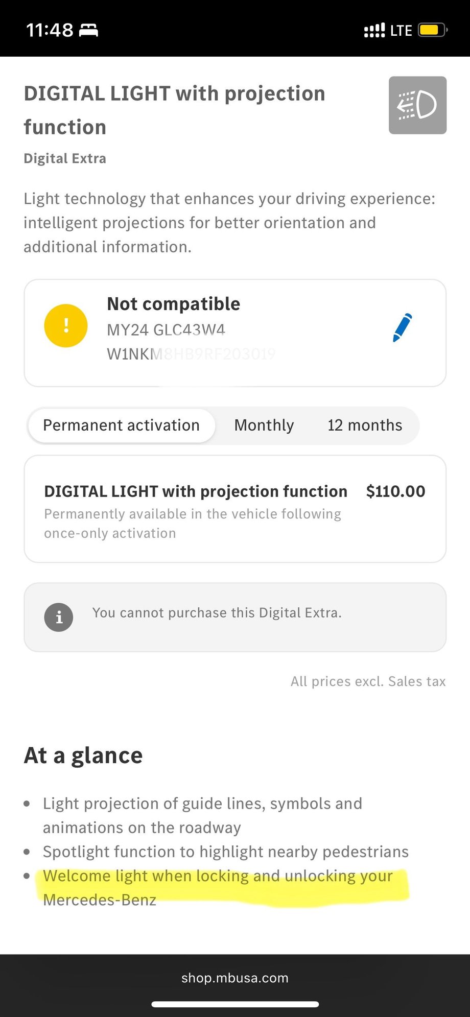

On a separate note, does anyone who owns a 2024 GLC43 confirm that they can see digital projections on the road surface?
On the mbusa site, when configuring a new car it says "DIGITAL LIGHT technology can project visual alerts into the driver's view. A variety of icons can appear on the illuminated roadway, to help alert you to detected issues such as construction zones, pedestrians, lane drift or following too closely."
Mine doesn't project any visual alerts onto the surface and my dealer says its a GLE feature.
This is an extra you have to buy: https://shop.mbusa.com/en-us/connect...n-function/714

Originally Posted by Eaton
It says not compatible. But mine does the welcome animation when locking and unlocking. It has the Pinnacle trim if that info is of any use here.
Or are certain functions limited by region?

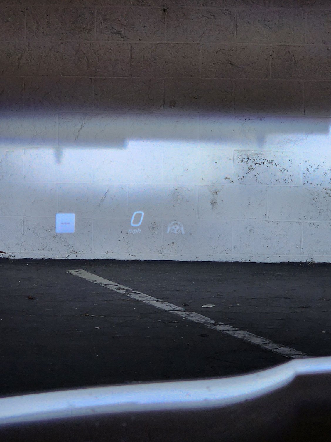

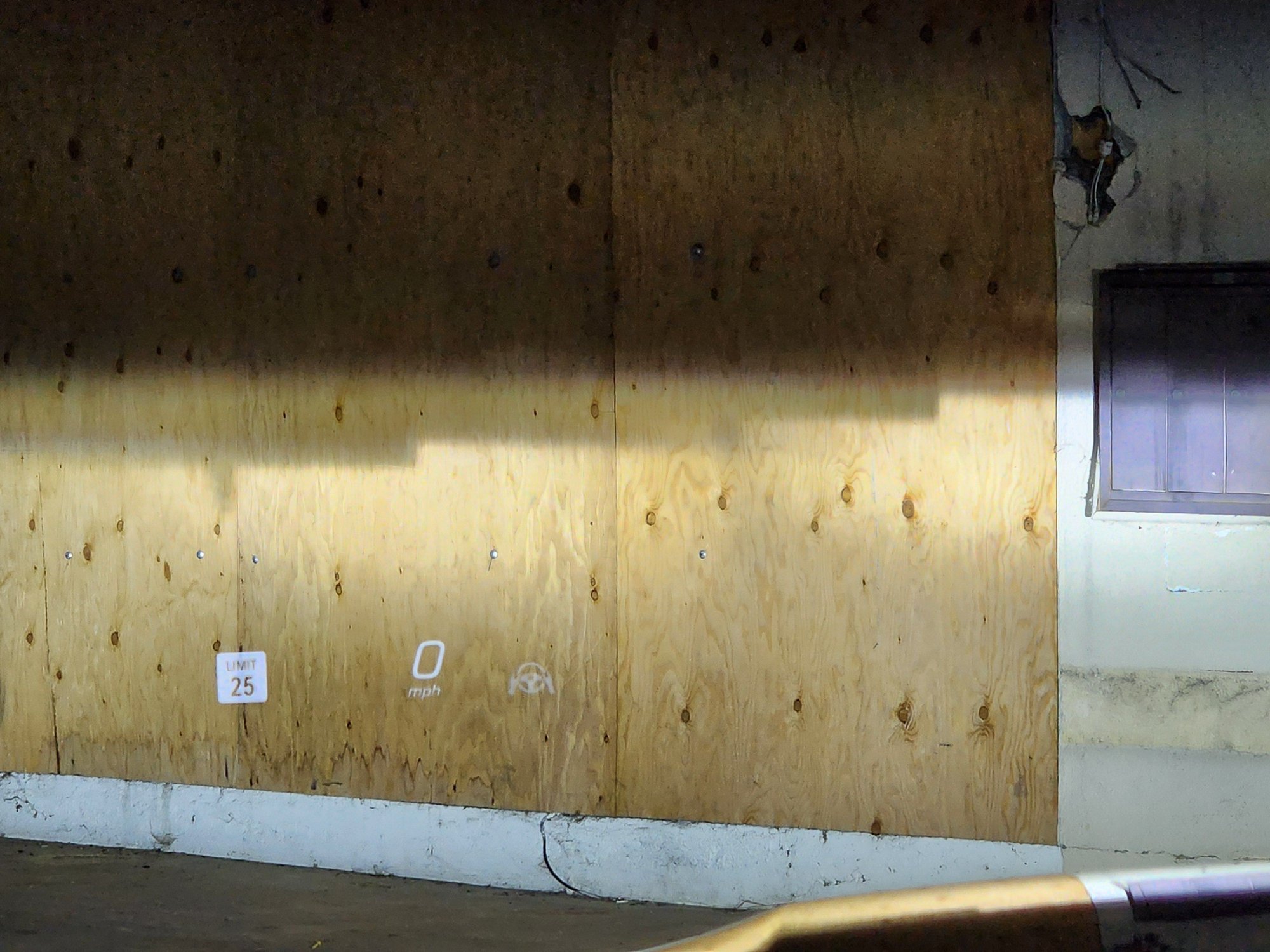

We see stair step and downward pointing cone shadows at night
Hi all,
Our 2024 GLC300 has the same issue with our digital lights. Further, we've never seen the projections. We have paid to subscribe ($150/yr) to all available items (projection included) and enabled all available projections in MBUX. My wife first noticed the shadows driving at night, April 2024. I've taken it to the dealer and I showed them the issue. They looked at another vehicle with digital lights and told me the shadows were there too. So, there was nothing they could or would do.
I wrote to MBUSA 3 times. Provided pictures and a video. No response. I wrote again a few weeks ago expressing my frustration with Mercedes stating my next email was to NHTSA. This is a night time driving safety issue. Someone from MBUSA finally called last week. She was calling to gather information before referring me to the next level support. That person called me today. He wanted me to make a service appointment at the dealer and let him know when the GLC300 would be in the shop. He would coordinate with the dealer to verify the issue and how to proceed. The appointment is Thursday 7/30 at 8am.
I encourage everyone with this issue to write or call MBUSA.
I'll provide an update when I get more information.
Thank you, Sal
Photo taken about 10 feet from wall

Photo taken about 20 feet from wall
Photo taken about 15 feet from wall
