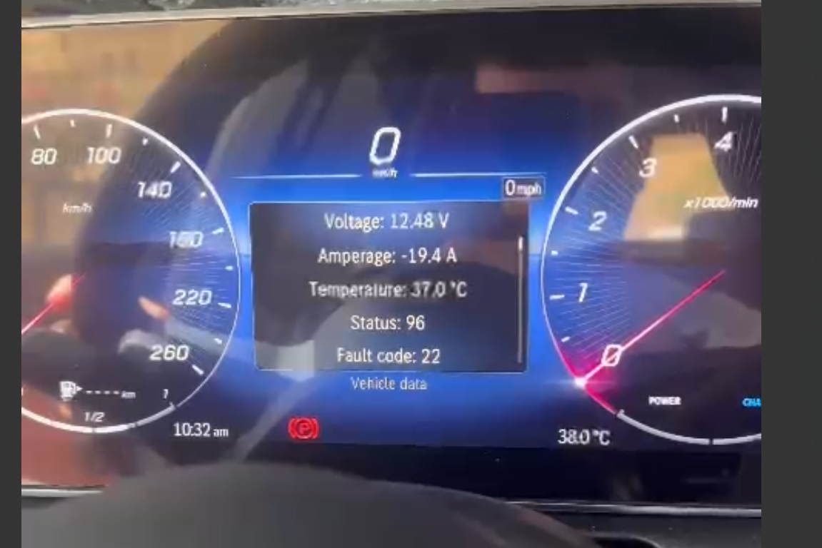

Old May 20, 2025 | 11:01 AM
Steely's Avatar
Joined: Sep 2022
Posts: 156
Likes: 26
From: Texas
C300 W206 2022
Here is what I'm seeing
Old May 20, 2025 | 04:08 PM
W205C43PFL's Avatar
Posts: 32,217
Likes: 6,275
I see, thanks for the image.
Did you have a chance to check it after driving for 60 minutes on the highway or something? Or check it after fully trickle charging it? If you have a CTEK, you could use AGM float as well.
The previous image was with the engine running. I checked it today right after 20 minutes of Hwy Driving , with the engine off and it read (-)21.5A and 12.4 V. I will take one with it running next time.
Old May 20, 2025 | 07:23 PM
W205C43PFL's Avatar
Posts: 32,217
Likes: 6,275
Need to drive for at least 60 minutes on highway. Don't worry about it to be honest but fully charge should go down.
Old May 20, 2025 | 07:39 PM
Thekiller114's Avatar
Joined: Jan 2025
Posts: 71
c 300 w206
Mine has a fault code 22 what does it mean
Old May 20, 2025 | 07:43 PM
W205C43PFL's Avatar
Posts: 32,217
Likes: 6,275
Originally Posted by Thekiller114
Interesting yours say fault code the other forum member's say error code, does it change when the ignition and engine is on, I can see your engine is not on.
