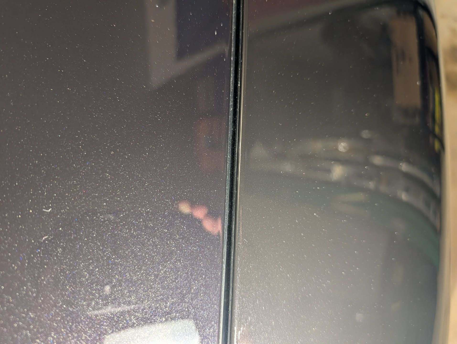

Here's a close-up picture with bright lights on the surfaces. From a distance, this is really not visible.
What exactly would I ask a dealer? I would have to look at another car in person to see if they look the same.

It is normal to have a slight difference in color between the bumper and the metal panels. It's due to how the metal flakes lay differently on plastic vs metal. I've never seen it this stark, though. I just shined an LED light at my car and I can't see a difference between the bumper and the adjacent metal panel. However, my bumper is also covered in PPF, and the quarter panel is not. I can see the flakes in your paint, so it doesn't look like one is Obsidian and the other is not, but the shade is quite different. The panel has the purple sheen that Obsidian has, but your bumper doesn't have it. Almost looks like the bumper is just a regular metallic black.

Take a picture of the front bumper at the same light conditions and compare.

This is not the original front bumper. It was replaced by the dealer's body shop after someone hit my car in January.
It's gotta be the angle that I'm looking at it. I really did not notice until yesterday. Can anyone else reproduce pictures like mine on their car?

That is not normal and does not look like the same paint. You are taking it more lightly than I would. The recourse would be for the dealer to make it right via Mercedes. I personally would not settle for body shop work with a new bumper painted to match. They will not age the same.

Yeah, something's amiss here. Is it possible that the body shop also repainted your rear bumper? Where and how did your car get hit? I'm not surprised that you may not have noticed it. The purple sheen only comes out under certain light conditions. Unless there's something about the plastic they are using on the W206 that makes Obsidian Black look terrible, there's something else going on. I would investigate what exactly the body shop did. That's new information you didn't mention before.

I went to a dealer. The service rep said they didn't see it and just said it was the angle the picture was taken and the way I'm looking at it.
I looked at another car on the lot (E43) with the same paint, and it appeared to have the same difference between the paint on the body and rear bumper. It's hard to get in a picture since it was overcast. I guess it's just a thing with this color.
It's probably just as was pointed out above by Tim.

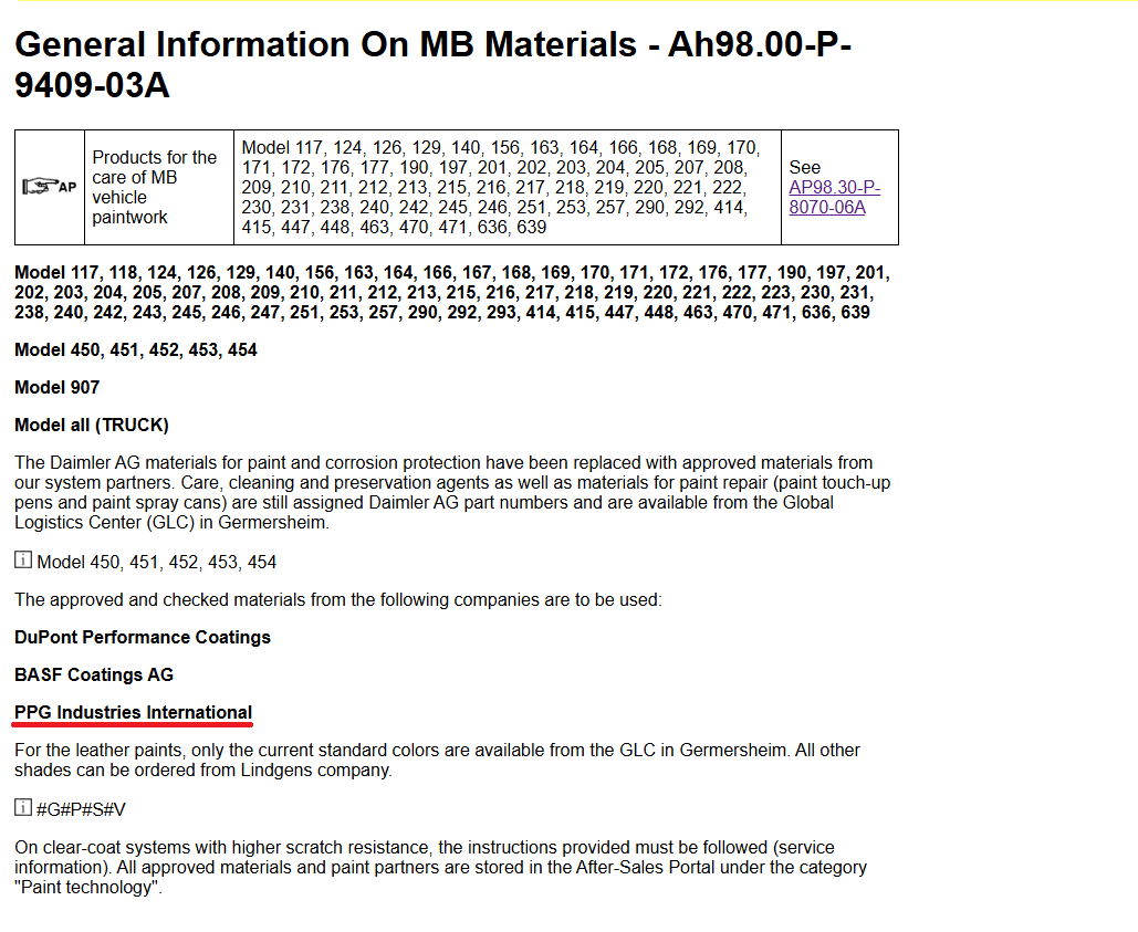

After the recent collision of my W206 (https://mbworld.org/forums/c-class-w...sion-w206.html), at the body shop they used spectrophotometer (or a similar instrument) to determine the exact color in order to paint the new rear bumper. They told me that there is a slight difference between the factory-installed bumper and the body, probably due to the difference between plastic and metal. It is hard to notice this difference though. My car is just black (not obsidian).

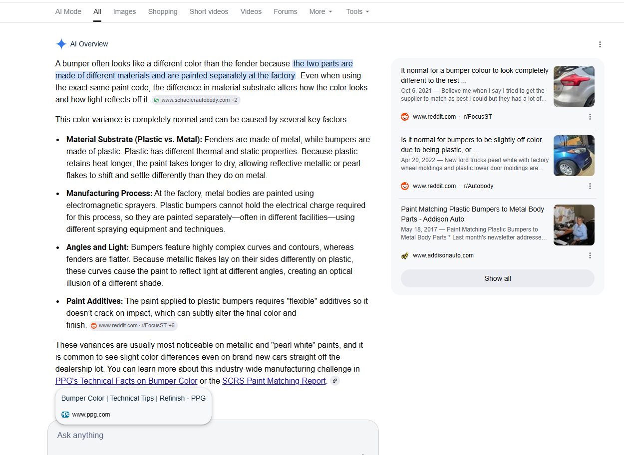

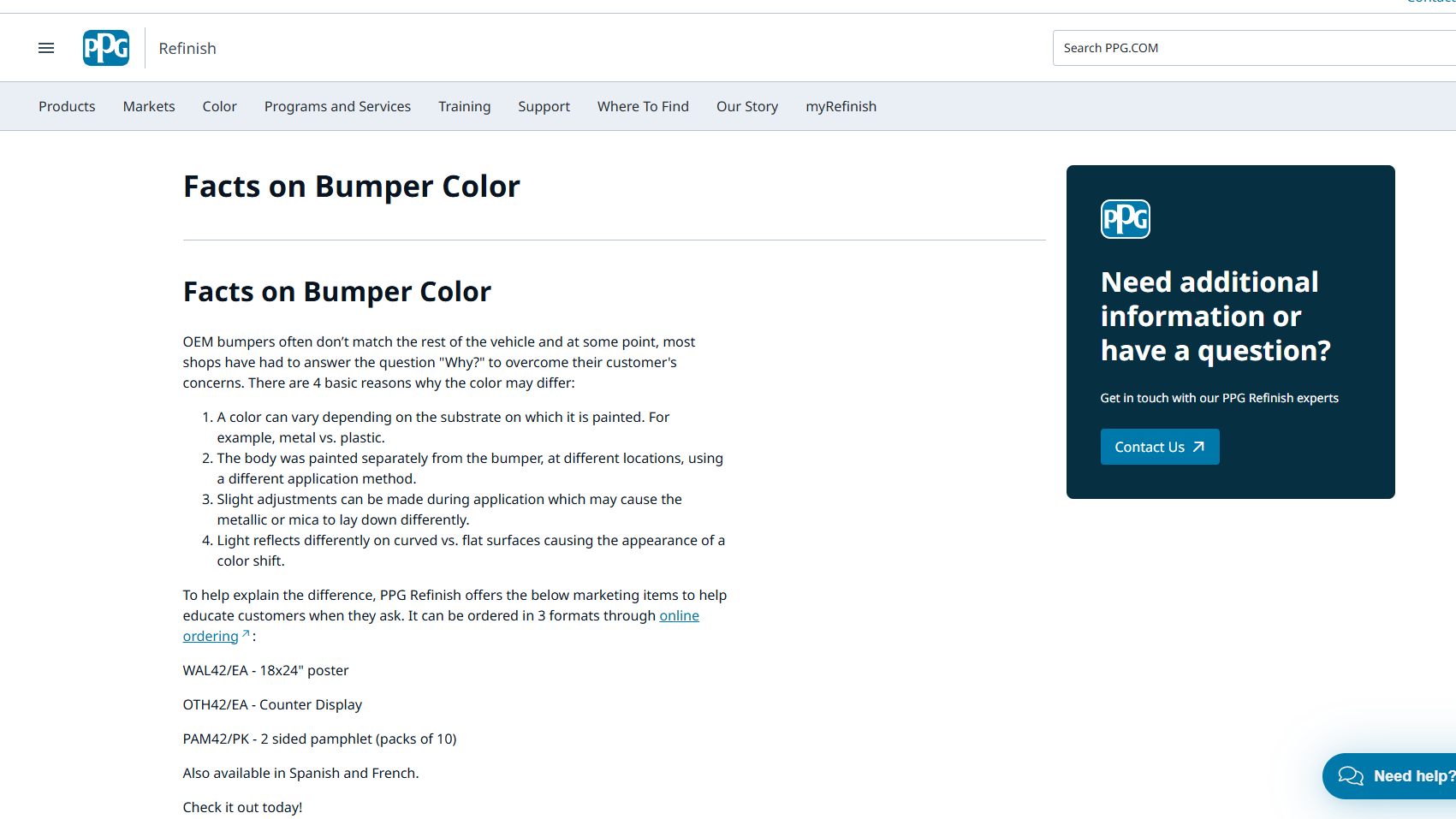

From searching "why a bumper can look a different color from fender" this seems common. Explanations range from different sub straights - plastic v metal, panels painted separately even at different facilities, different curves reflect light differently. I guess the metal body is painted then put in an oven to cure the paint where plastic bumpers cant be put in an oven, also a different type of paint or additives are used on plastic so the paint can flex. Seems like reasonable explanations.
As already mentioned hardly noticeable until someone points it out. Now you will be walking thru parking lots looking at car bumpers.
