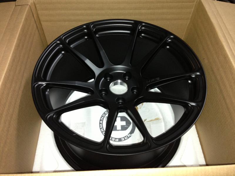

I would have preferred to go 20's but it's illegal to run tyres with a lower load rating than the stockers here in OZ. I'll be sure to post up pics when it's done.
