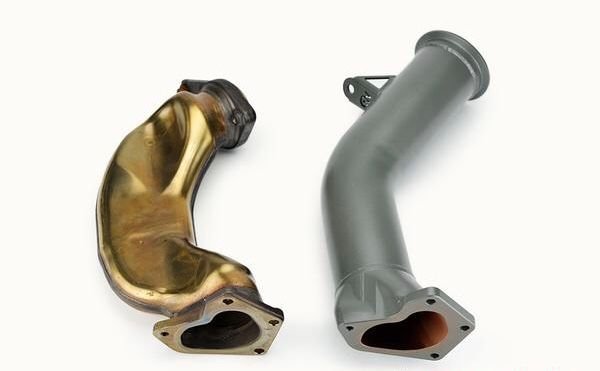

It’s been a learning process for me too. For the m157 and m278 there’s downpipes that start below the bridge pipe, which is the piece that is bolted directly to the turbo. This piece has the cat attached.
Then there’s turbo back pipes, which replace the squished looking bridge pipe and lower portion all together. However, for the 4matics these would require dropping the engine.
the first option would still remove the cats
Vs
so there are DP's that bolt directly to the squished stock pipe? that seems really....dumb? is that the bridge pipe that everyone is talking about? that seems to be a pretty big restriction to over come by opening up the diameter AFTER it. i havent really looked into DP's because of the aforementioned smell. thanks for teaching me something new.
but yeah...if you want more power....i'd get rid of the flattened piece. hahahaha

power increase is very minimal, if anythings its just more responsive on the low end tq. the car sounds more throaty a deeper exhaust note. power wise its all BS. I didn't do a dyno after just the downpipes. but I have done several runs on the drag strip and there was no change in the times or mph. not even a mili sec change. if you were to gain any power, you'd be incredibly lucky to get 50hp, but realistically expect 10-20hp nothing more.
the bridge pipe does need to be replaced with a wider diameter pipe to remove the airflow restriction. essentially all downpipes do is let a larger volume of air leave the engine faster. Turbo engines do need a certain level of back pressure to keep power levels up but you do lose power on top end.
I don't believe the engine needs to be dropped to do the bridge pipe, I will double check with my installer

The weistec turbo back system is nice. Unfortunately weistec system was knocked off and is now being imported from China. If you buy the chinese knock offs and have an AWD car you have to remove the engine then have turbo back pipe modified to fit the AWD car. Not only that but Mercedes along the way swapped mounting bracket locations. It just happens to be that the turbo back downpipes when they were copied had the original exhaust hanger locations. This mean if you have 2014+ (not actually sure of the year) your exhaust hanger location is different of that from 2012-13. So for a lot of unknowing people they have their turbo back downpipes being held up my the turbo flange and the factory resonator. This is because the exhaust hanger locations are not correct.
With a standard downpipe, the install is less than an hour. If you need to swap back to stock, again install is under an hour. With a turbo back system what the R&R time on a engine? Then potential fab work on top of that? The install time and shop labor rate will maybe be more than the cost of the downpipes.
