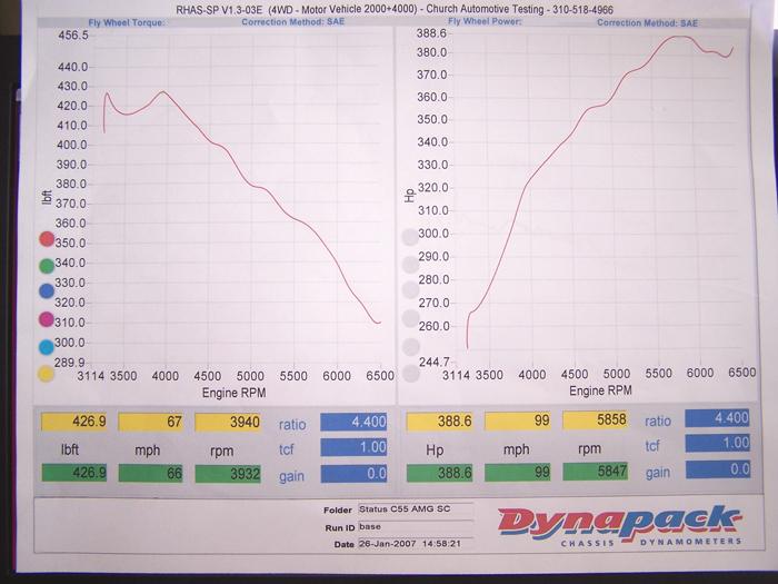

My last dyno before Splitter, TB, Johnson Pump and Heat Exchanger Upgrade
Originally Posted by JamE55
So what's next Rob(AMGSC)?
This was the only dyno chart Jessie saved for me. It's not the 438rwtq but it's closest to reality after several back to back runs. Since I already bought the Johnson pump and the splitter & throttle body are so inexpensive that I might as well throw them on to see if they make any difference. I might stick the smaller pulley back on also since Kleemann's run .5 bar which is 7.3psi and I am only running 7.0. The 2.65in dia pulley should bump up my boost back up to 7.3. Then we can get an apples to apples comparison between the highly efficient Kleemann and the turbulent HPS kit. All this experimentation can benefit a prototype design as well. Oh and next time I will fill up Methanol/Water in the tank since it was empty when I dropped it off. Mechtech gained 10rwhp from turning it on with a full tank of spray on the chart I posted earlier.
As you can see, Jessie leaned it out a bit and the torque improved by 26rwtq, the 389rwhp was dissapointing on this run but he only charged me an hour of tuning although he spent nearly 6 hours on the road and dyno. Jessie is not only the MAN but fair as well. He told me that if he did'nt make ANY power it would be 100% free! That's quite a guarantee when dealing with a flawed kit to begin with.

Which Gear gets higher RWHP? 3RD OR 4TH?
A friend just pointed out that Jessie's dyno of my car was run in 3rd gear since the peak HP occurred at only 99mph while my dyno at JBA was run in 4th gear as the peak HP was at 123mph.
So which gear is the correct gear to dyno and which yields more power?
Really? I've never heard of a dyno run on 4th gear. Majority of the dynos I've seen done have been in 3rd gear.
Old Feb 3, 2007 | 03:48 AM
  #1219
sdsilverm3's Avatar
Joined: Jun 2005
Posts: 2,441
The majority of the E55 guys recommend 4th gear. Some dyno shops are hesitant to do that because you're at some insane speed at the top of 4th gear.
