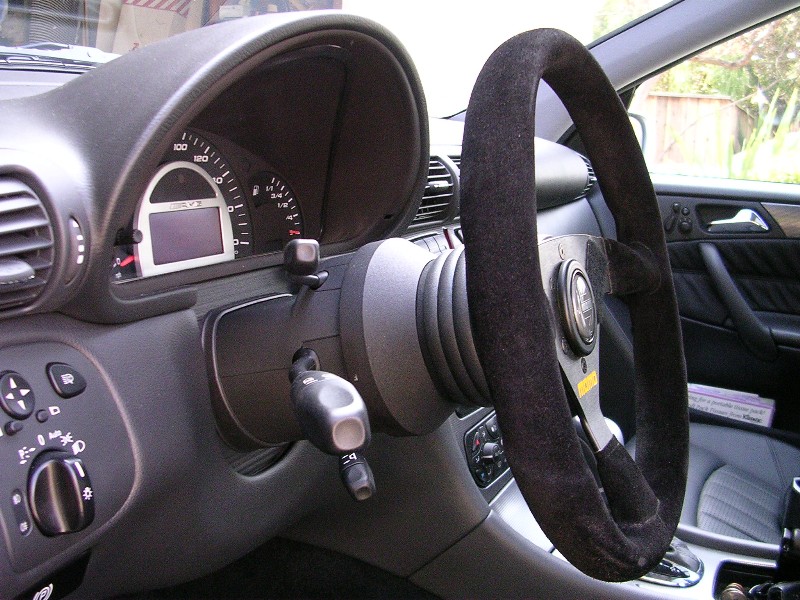

I dig that, but I always wonder then how you access the menus. Sans COMAND I don't know how you would get to those menus/options.

Originally Posted by smgC32
I personally don't understand why you would eliminate the airbag.

yeah, how do you change the the options now which you wold do form the steering wheel mounted controls??
he's got to lose them.
