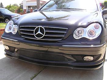

Just did my Bi-xenon swap last night. I got mine on ebay for $750 and they look like new.. Talk about a score!!! Booya..
Took me about 2 hours because I didn't have anyone to help. Found the directions by searching the FF.. lol..
It was pretty easy, and fun.. Man what a difference.. I am so happy.. Now I just need to get my exhaust done.. hopefully next week!
Here is a pic from last night.. yes it was dark too which also delayed the install.. It was just too hot to work until after 7..
very nice and wat a steal on the light.
