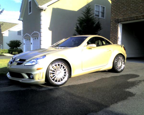

On Pole Motorsports would do better with the proper marketing. I built a nice SLK55 recently.

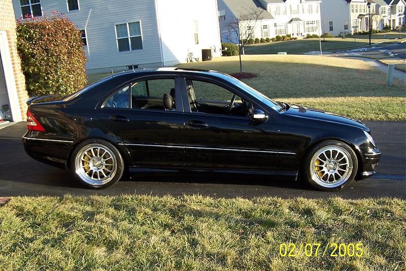

kind of like mines, but darker:
