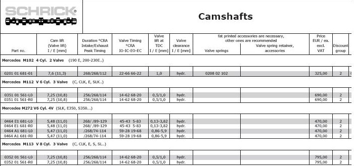

dear AMG-Jerry, I just finished reading this awe 3d and was thinking about a Schrick cam for my 55 engine
..looked at their catalogue but it seems to me that code for their C32 cam is different from that one you installed or perhaps I missed something in your posts
The one in their catalog is for the non supercharged motors..stay away from those!
If you want to buy cams for the C32, call Ron.
Part numbers 035101681-L0 & 035101681-R0.

thanks for reply, but I need for 55
perhaps those showed in catalogue for 113 engine are for non-kompressed engine .. as I called them some months ago and told me they had not a regular production tuned cam for 55

Be careful . . . I have good reason to believe that those cams do not work properly in 03-04 C32s. I went to hell and back several times trying to get those to work. It was a very expensive learning experience. The gains were not that impressive. Schrick disappeared when the going got tough.
