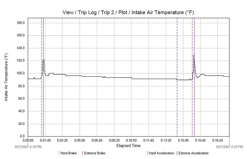

Jerry, thanks for posting the IAT graph. My carchip is to be delivered soon and I can compare my data with yours as I still get S/C cut off in some rare cases, likely due to high IAT. I had the I/C pump replaced 10 months ago, which addressed much more frequent S/C cut off.
I can now make the S/C cut off at will: after cruising on the highway for say 5 mins at 80 mph, I floor it to 110 mph and it reaches that speed in a few seconds with S/C working - great. Then I let the gas off and leave the car to go back to 80 on its own. Then I floor the gas again - S/C works for a split second and then goes off, followed by sluggish acceleration and mellow engine sound. The weather is not hot BTW, car is stock

Might not put it out of the realm of possibility that the intercooler pump is shot again
Yeah, let me know when you get some numbers to compare to. It sounds like high IAT's, but when you slow down, the temps should drop fast....might be the pump like Bif said.

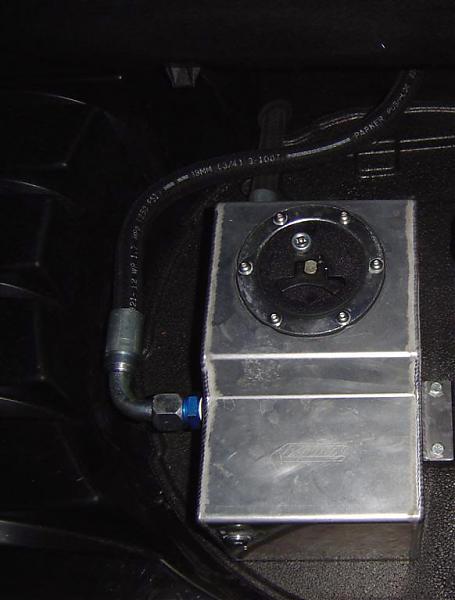

Update:
New IC Reservoir installed!
After 9 dyno pulls and over 1.5 hours on the dyno, the water was colder than ever before. During 20 minutes of data logging on the dyno, the car only got above 100°F during pulls and dropped back below 100 as soon as the pull was finished.
The new setup with the lines added 3.5 gallons of water to the IC system. The Johnson pump was moving the water perfectly.
We were on a dyno dynamics dyno and I managed to pull consistent 320ish whp everytime. The last time I was there I pulled 260whp.
Attached Thumbnails Porting, Polishing, and Cams project-tank.jpg   Porting, Polishing, and Cams project-iat.jpg

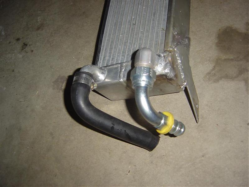

I bought the tank from http://www.rpmoutlet.com/lightasp.htm. It was only $149 and is the perfect tank for our car. There is no way you can make a custom tank for this price. Thanks goes out to 1fastc32 for the link to this product.
I have mine installed in the trunk (duh) and 1fastc32 has his installed in the battery compartment. I wanted to put mine in the trunk vs under the hood because it will be a good test after 1fastc32 and I test water temps.
I had CPT (Chicago Performance Tuning) install it and it wasn't that hard at all.

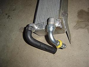

I had them take the inexpensive heat exchanger that I bought from http://www.lightningforceperformance...bra-p-319.html and weld a 90 degree fitting on it to match the more expensive units out there. See pic...
The lines ran on the passenger side of the car and using nice gromets and brackets, they were able to pull off a professional and clean install.
EDIT: The lines are 19mm (3/4 inch) soft braided Parker Hose. Check out their site. http://www.parker.com/EAD/displayCat...AKE/MARINE/GAS
The tank water was warm to the touch after 1.5 hours on the dyno with only fans cooling the HE. Try sticking your hand in the coolant water after 1.5 hours on the dyno!
I'm 100% sure everyone needs to do this mod. Check out the before and after IAT's. This is with the stock HE on the car too. I will reinstall the new HE later today and do more data logging.

That is really trick! Can you tell me the steps that it took to isolate the intercooler coolant from the car's radiator? For example what was done with the lines from the radiator overflow to the intercooler system? Where they simply plugged?
Ok, I'll try to get you some pics later...remind me if I forget...I have a horrible memory.
The bottom line on the MB coolant tank was plugged.
The T fitting on the overflow line (above the radiator) was removed and a coupler was put in its place. The line that went from the T fitting to the IC lines was plugged.
The bottom line on the HE routes to the Johnson Pump.
The top line on the HE routes to the bottom fitting on the IC tank in the trunk.
The second line on the IC pump routes to the top fitting on the tank in the trunk.
