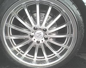

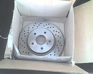

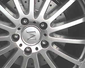

I updated the rears, painted the calipers.
I ordered oem fronts from oempartsdirect.com, maybe its just me but they seem a tad bit dull.
I think I'm just *****ing a little.
Last pic is the oem front.
Attached Thumbnails C55 rear rotors?-img107.jpg   C55 rear rotors?-img108.jpg   C55 rear rotors?-img109.jpg   C55 rear rotors?-img120.jpg
