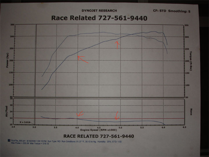

Ok now that i have your attention. I will try to make this short. A while ago i purchased two Evosport stage 2 kits, one for me and one for my good friend, since purchasing only one has been installed. Since installing the first kit on a 2003 w/39000mi. i haven't been able to get anywhere close to the dyno numbers or the track times that i'v have read about on this forum. This is why only one has been installed. I have had the car on two different dyno's and hp numbers were the same, approx 320rwhp, i have also been to an 1/8 mile track and the best time so far has been 8.6. I have spoken with Vadim and Evosport several times reguarding the low output of the car and haven't got any further progress with the car. I have sent the ecu to them two different times and still the car is still the same. Unfortunately i don't have pre install dyno #'s, but i did run 8.8 1/8mi with bone stock car at the same track as the 8.6 post install. I have also installed a boost guage to try to troubleshoot the car and the boost is 17.5 psi 3rd gear pull. I also have had the car on a scanner to read iat's and they are right in line with what i was told they should be from Vadim. I dont have any idea where to go from here. I was hoping that with all of the knowledge from this forum maybe i could get some help!! If anyone could ((PLEASE)) lend me a hand to get to the bottom of my problem....i would be so very thankful, as i feel as if i have wasted a lot of money!!!!

the afr varied a little most of the pulls wrer a little rich, as for the car being low hp stock the car ran an 8.8 in the 1/8 mi which is what i think is on par for stock car.

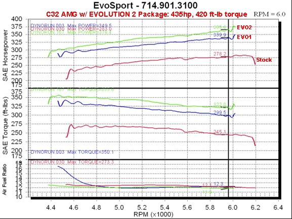

Evosport also started with a low hp stock car!

Mind you, with an AFR of ~11:1 for most of your dyno pull, that would suggest that the ECU map is in fact off, right? Even the Evo AFRs are right around 12.5:1.

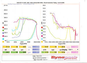

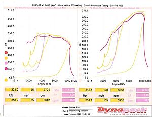

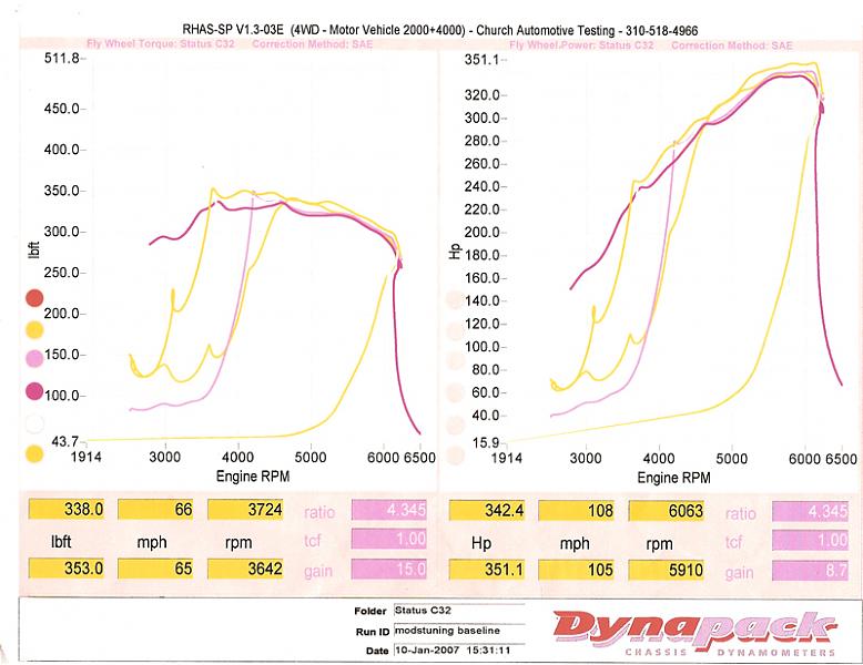

EDIT: found mine...attached the pic. btw, nvm the all weird out graph...the tech that did the dyno couldn't get the shift down
Attached Thumbnails Please Help!!!!-dyno-graph.jpg   Please Help!!!!-fuel-map.jpg

Evosport shows a stock car and the stage2 in their dyno map, but is that the actual same vehicle, or two different C32s?
Old May 1, 2007 | 11:36 PM
FrankW's Avatar
MBworld Guru
Joined: Apr 2002
Posts: 22,058
Likes: 18
From: Diamond Bar, CA
W206 PHEV AMG
the one evosport shows has always been Vadim's car.

The car has been dynoed 3 diffrent times. The afr has varied from 11.5 to 12.8 on diffrent pulls. Remember 320 was the best pull. I have other dyno sheets that show less hp and higher afr, again this is why i am searching for help. I have been trouble shooting the car for the past 7 months. I personally think there has to be something i'm missing.
Personally, I think you are running too rich after 4000 RPM. I would be willing to be that you have a leak in the system somewhere.
