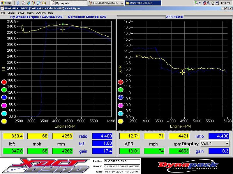

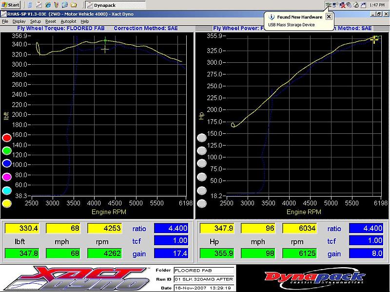

Posted same on benzworld/r170 forum. Now I wish I had of resolved my A/F ratio problem before having the headers built, see below.
Dyno results...
Hmm... complicated. The showed a gain but the gain is limited because the A/F ration actually got worse. It does make some sense. The car is flowing more air but the ECU is not providing enough fuel. Renntech is going to take the car on Monday and do some tuning to add some fuel. However, for a real apples to apples comparison, I would have had to tune the ECU before the changes as it was running lean before the changes so the car might have made more power if I had it tuned to add more fuel. Of course, that is no longer possible.
The gain was across the whole power band which is nice and torque increased more than hp which makes it more usable power. The real test of the headers would be on a stock 32 with before and after dynos.
Here are the charts... I should have more next week when Renntech tunes the ECU. After the tune, we'll dyno again on the same dyno to get a better comparison with the dyno before the changes but as I said, it will still not be ideal.
Attached Thumbnails Header Project...-floored-power.jpg   Header Project...-floored-f.jpg

Steve - Your A/F Ratio seems fine. You want it to run a little lean for the extra power. If they were using an O2 sensor mounted in the muffler, then your actual A/F ratio would be 12.5, not 13.
Your A/F ratio looks just like mine.

Jerry, I'm not so sure. As part of the changes, I had the spark plugs changed to NGK BKR8EIX plugs. My previous plugs showed "pepper" on the ceramic of the old plug indicating detonation. If the car is detonating, the ECU will take out some timing which will decrease output.

Originally Posted by SteveL
...If the car is detonating, the ECU will take out some timing which will decrease output.
That’s true.
I’ve seen knock retard readings approaching -24 degrees at WOT. Did your dyno operator log IATs and timing?

Originally Posted by splinter
That’s true.
Not sure. I'll ask. Renntech will check when they get the car on Monday.
Steve, trust me, you are preaching to the preacher on this one. I've sent my ECU to Renntech more times than anyone else and the lean A/F ratio is still there. I've tried using the nitrous nozzle to add a little more fuel and this only resulted in less power.
I consider my car optimistic, it has high hopes that all systems are functioning well and adjusts base maps accordingly. If, the ECU finds that a single parameter is incorrect, it will pull timing / fuel.
I bet you didn't know that if your IAT's are 95 °F - 112 °F, the ECU will pull 3.5° of timing. If your IAT's are 113 °F - 146 °F, the ECU will pull 6.3° of timing. If your IAT's are 147 °F+, the car will pull 9.5° of timing! This only happens during full load situations....such as on the dyno. I was monitoring my car at the track and my IAT's only reached 95 °F once in the day. Needless to say, I was running 12.5's all day long and ran a personal best that day of 12.4.
So, if your IAT's are sitting at 113° F + during runs on the dyno (like most of us), then your ECU will pull at least 6.3° degrees of timing.
I would be willing to bet that your car is detonating due to cooling issues.
I'm only trying to help because I have been down this road, many times over. Get yourself a datalogger so you can pinpoint when the timing is being pulled.
What are your cooling mods? Is your IC circuit still shared with the engine coolant?

Jerry, thanks for the details.
Before this round of mods, I still had the stock cooling system so maybe that is why there was previously some detonation on the old plugs. With this round of mods cooling should be more than adequate. We added a much larger intercooler, a remote reservoir in the the trunk and 2 Johnson CM30 pumps.
The dyno tuning with Renntech is not going to cost to much so we'll see if I can get any more out of the car with some tuning.

I have another simple question, what kind of gains are people getting with headers on C32s? Any difference between gains on a stock C32 vs gains on a pulley/ECU/etc. C32? Thanks.

i put the evo headers on my car and did not gain anything...

Interesting.... any idea why? Is the stock system good or are the cats too restrictive to see a benefit from headers? What kind of gains are you expecting with your headers?
