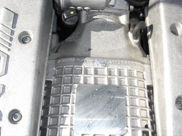

I know my S/C doesnt have a hand stamped data plate on it. Does that mean the S/C was replaced before or the plate just fell off? Thank You. Wait...is it only 2003 and later?
02's didnt get them.

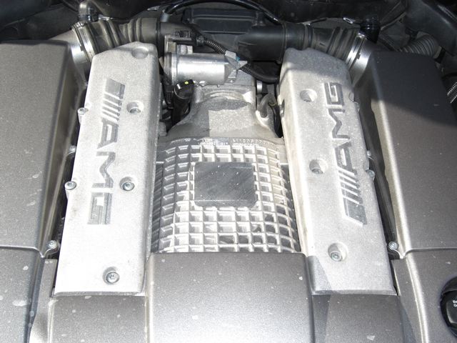

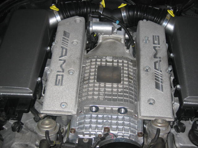

Originally Posted by hkycoldrct
Snap a picture of the new supercharger and post the picture here. I'd be suprised if they did not carry the C32 supercharger anymore. Maybe your dealer had something else on the parts shelf that crossed over and used it instead of ordering one from Germany?
Here are some pics. from this morning. Note the plate is blank. I do remember a sig. plate on the old one.
Well... the original sig. plate should've been from the person who built your AMG engine. A replacement S/C wouldn't have a laser-engraved sig.; logically that makes sense. Doesn't mean the part itself is in any way different from the original spec, though.
I'm 99% sure your s/c was replaced before. The original 02 S/C doesn't have a blank space on the center.
BTW, from time to time you can find the plate on ebay.de.
I should get one from "Joe American" with a US flag watermark or something at my MB dealership since he essentially rebuilt the engine. It just looks weird being blank. . . maybe he just is not as proud of his work as the Europeans. . .

RLPIII - you should ask the dealer to take the one from your old SC.
If they are clueless, give them PN 0002211001. That's what you need.

MB called this morning and said they were ordering me another plate.
So, it looks like I'll be getting it put back on when it comes in.
