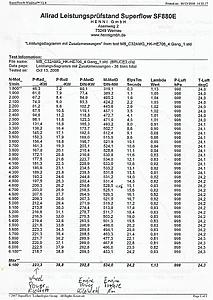

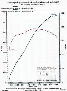

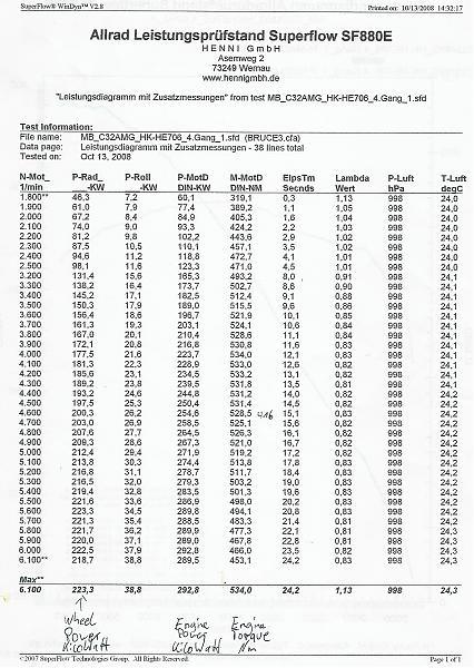

Can anyone help me make heads or tails of this???
Had an AMG Dyno day in Stuttgart today. There were about 7 or 8 cars including: 2 x C32, 1 X CLK55, 2 X C63, G Wagon, and 1 x E55 cant remember the rest. Awesome cars and awesome folks. Thanks Ralf (German32er) for setting it up. That being said, I cant for the life of me figure out what im looking at. If someone can help with a URL to a conversion chart or tell me RWHP and RWTQ. Also how does my A/F look? Temps were about 71 Deg.
Thanks in advance.

Looks like your torque is in Newton Meters and HP is in Killowats
If your KW is 290 that means you have 388HP
1HP = 0.7456KW
Not sure that the newton meters are to torque but its much less than 525

It looks like 392 hp and 393 ft/lbs of torque, calculated from the 398 DIN and 534 Nm values in you graph.
IIRC, the multiplier for NM to Ft/lbs is 0.7376 and DIN to SAE divisor is 1.013
Healthy numbers. Who tuned your car?

i came up with 387tq as well but I thought my math was wrong guess not.
How much HP and tq you have will be based on a solid number So I was just ballparking from the graph.

Jerry/ LET tuned it. Are we talking to the wheels here? It seems high to me but im not complaining.. Should I subtract 17% for the drivetrain?

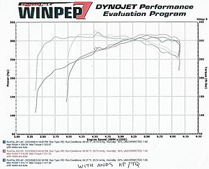

Past Dyno
So....Old Dyno with non-LET tune and same mods made Max 316 RWHP/ 331 RWTQ.
New Dyno with LET tune and same MODS made 325.9 RWHP and 326.87 RWTQ assuming 17% drivetrain loss.
I lost some TQ and gained some HP? Is this a DynoJet VS Superflow Dyno thing? Weather/ Temp maybe.

Sorry bud, I can't figure out that dyno graph for the life of me... but it does appear that you're at 393 hp (292.8 kW) and 394 tq (534 Nm).
If that's at the wheels, you have one of (if not the) strongest "all-motor" C32's in the world. Could their software have been performing a "crank-conversion" calculation?

To my understanding those numbers are for the rear wheel so add 17% to find out crank HP/TQ...very healthy

Hello Mark,
seems you had a very good time at Hennies. Maybe the next time I will come too, when I am not so busy at work.
Chicago X and C32 AMG-DTM converted the HP correctly. The Graph shows 292 DIN-KW (398 HP at the crank/motor) and 534 NM (398 Lbft) at the crank. And Lambda 0,83 is approx. 12,09 A/F.
Regards Bruno

Normal 93 octane (American not German). DynoFlow All Wheel Dyno. 71 Deg. Dyno Mode. Massive fan.

Is it safe to say that I dynoed at 325.9 RWHP and 326.87 RWTQ?

From Bruno's comments, I'd say that's safe to say.
If the dyno was somehow adding in a driveline loss assumption, you'd have to take that back out to get the numbers at the wheels.
398/398 at the crank would be 326/326 @ the wheels, assuming 18% driveline losses
398/398 at the crank would be 330/330 @ the wheels, assuming 17% driveline losses
healthy numbers either way - I'm only putting down a bit higher, and I have a similar (or same) tune, 181mm crank pulley, and headers.
