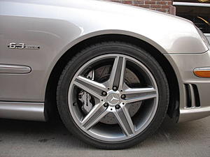

I would check with this guy:
http://www.mbenznl.nl/I have to agree though, I think it would look fantastic.
