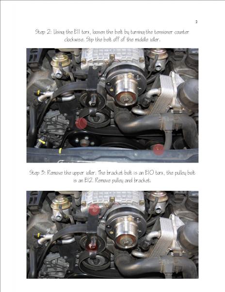

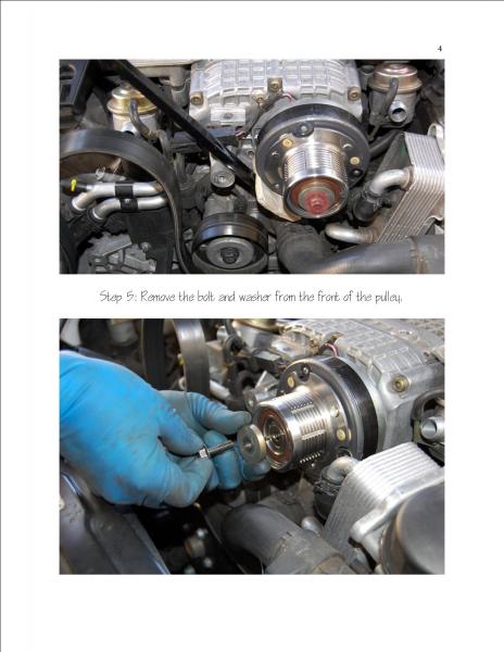

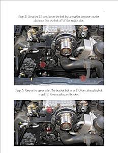

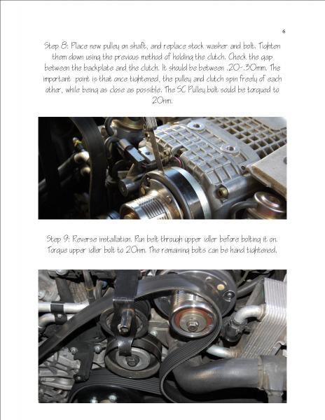

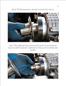

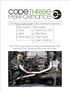

ok i searched but still not having any luck and CODE3's site isn't working for the DIY on the super chager
anyone have a copy of the DIY in PDF?

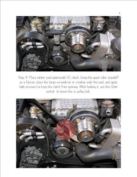

Page 7 in next post:
Attached Thumbnails supercharge DIY ???-install_page1.jpg   supercharge DIY ???-install_page2.jpg   supercharge DIY ???-install_page3.jpg   supercharge DIY ???-install_page4.jpg   supercharge DIY ???-install_page5.jpg

Last page:
