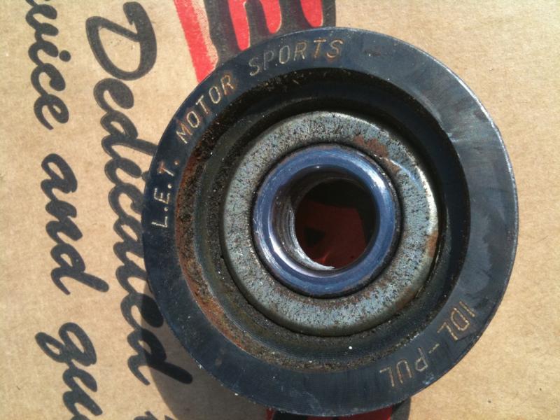

Hey guys I had the idler go out on me last night..thank God it was near my house..after some night inspection it was found it's all idler pulley related..opened my hood saw belt off and pulley is on under carriage cover as noticed by hitting the bottom of cover and it bounced..well anyways I haven't yet been able to recover the idler pulley but the bolt for it is toast..I honestly don't know if the idler was redesigned one sold in new 185 kits anyways been reading about this pulley saver kit by Needswings...please point out where to buy I presume needswings but is there somewhere else? On average to all who suffered idler pulley damage what required being replaced?

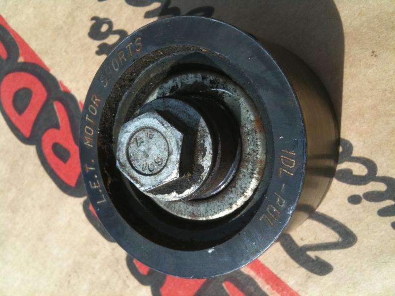

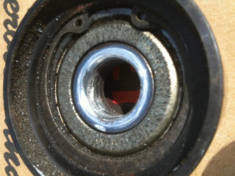

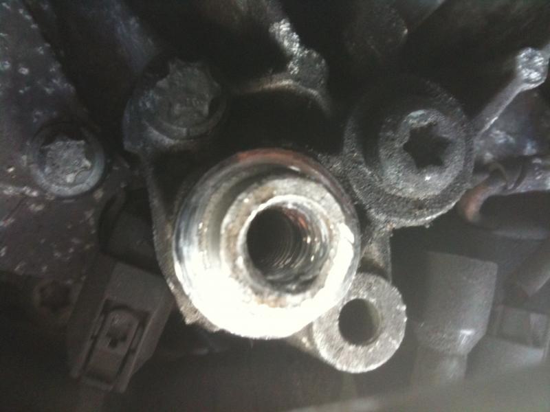

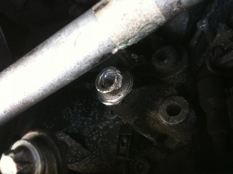

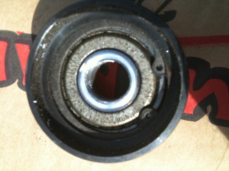

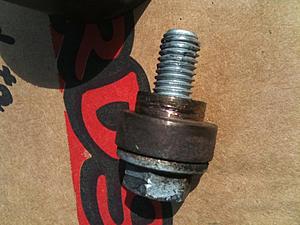

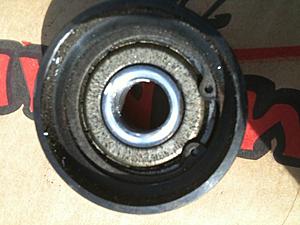

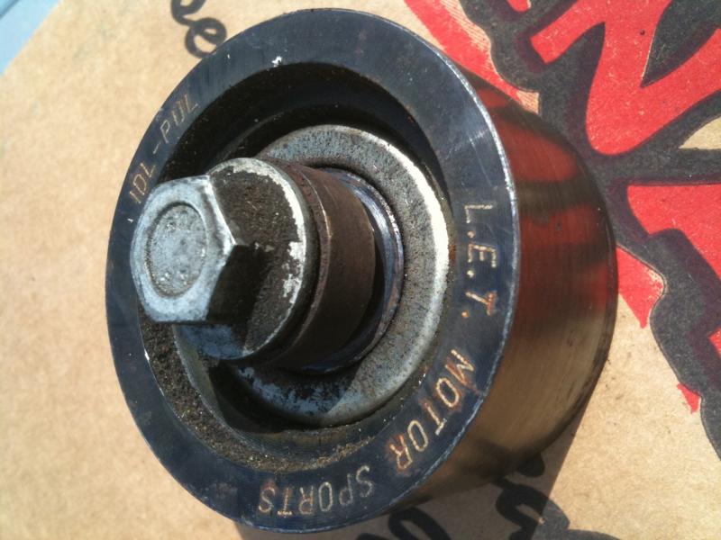

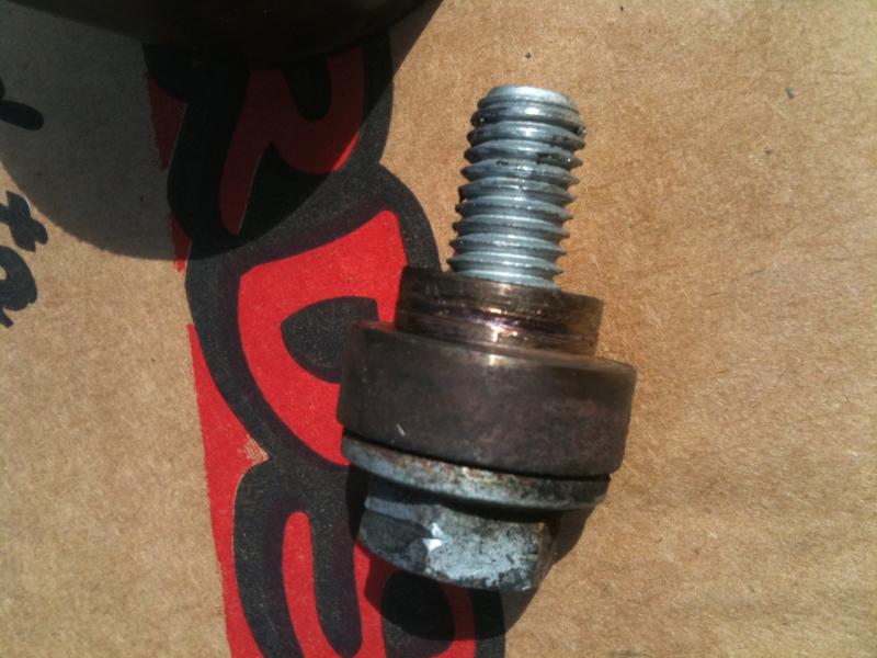

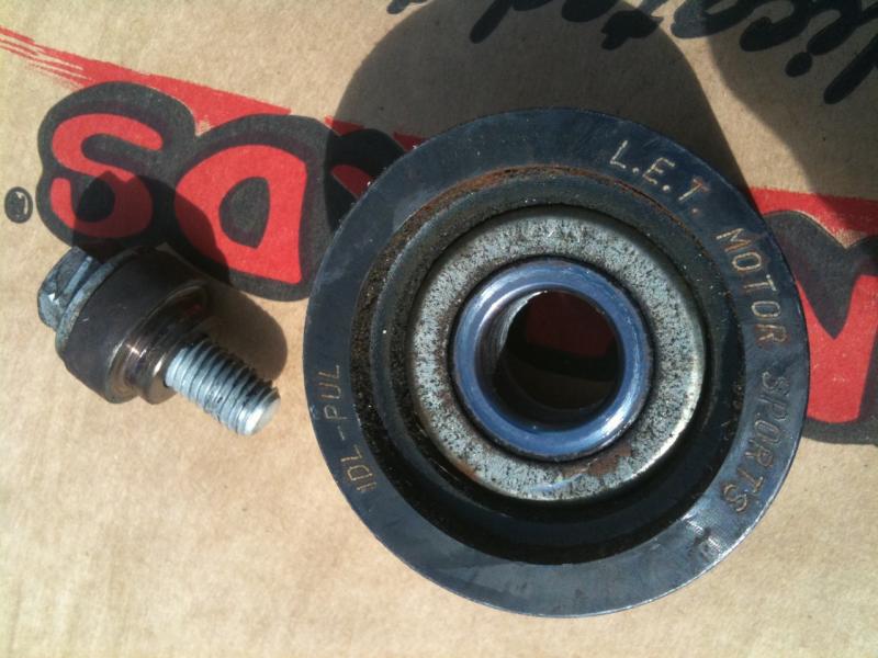

Listen guys checkout these pics I was going less then 1mph out of my driveway when I heard something from engine bay area fall as I turned my wheel...I honestly after examining bolt and idler feel it hasn't much damage...the location where the bolt goes only has the groves a little messed up at beginning but the idler and bolt have very little damage the belt don't look bad either..give me opinions? I'm thinking the screw got loose over time and by miracle it came off before I can rev engine to force further damage...I was thinking of putting it back on and once I get the PSK have it installed...what you all think?

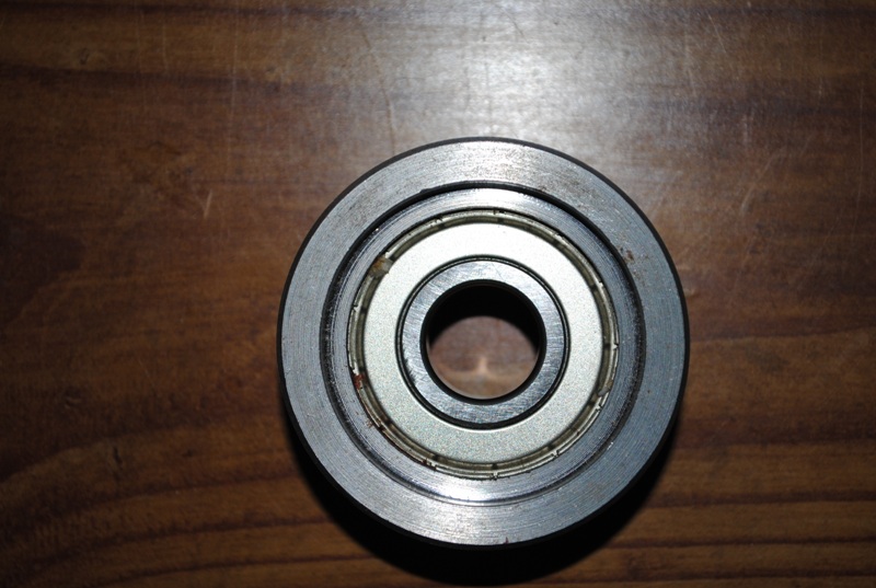

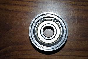

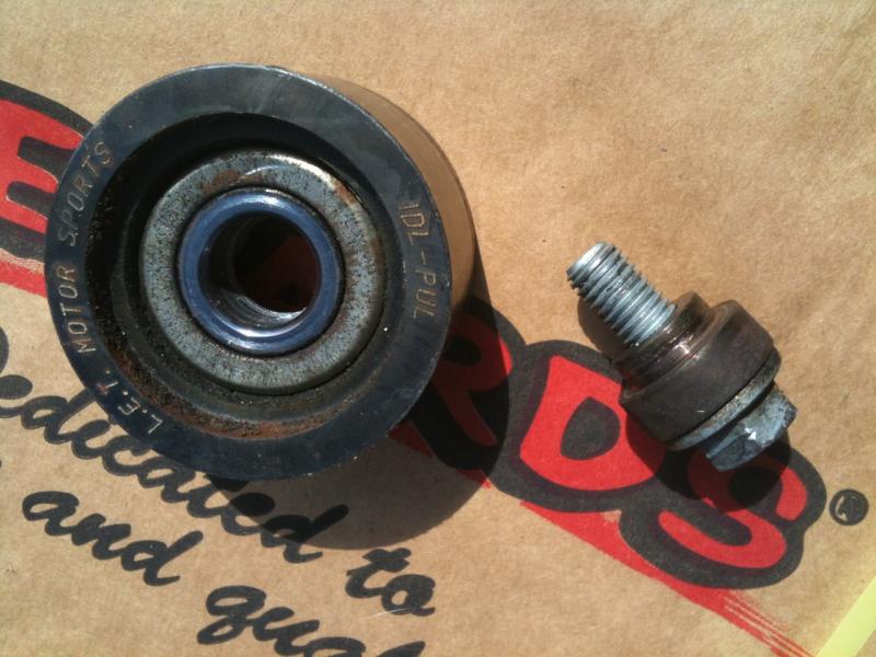

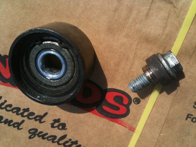

more pics

Looks like the bolt came loose. You can see where the pulley bearing was spinning, and grinding...
