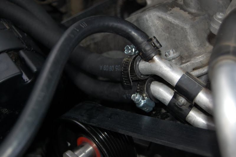

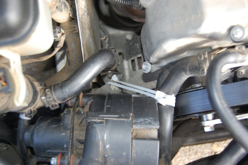

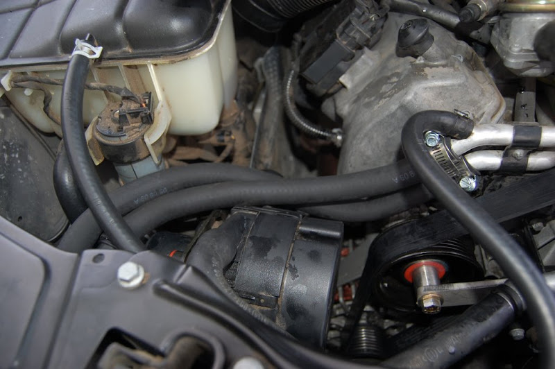

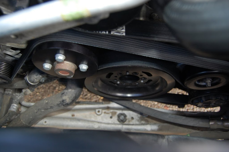

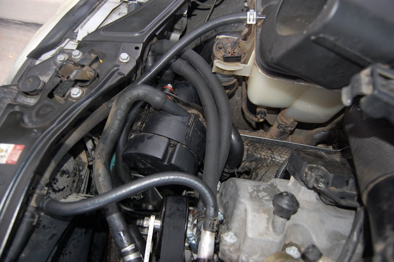

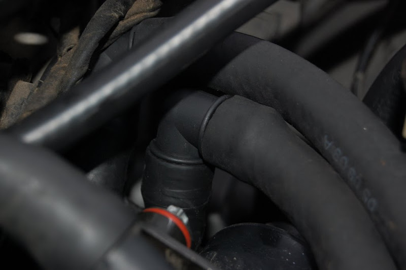

Went to autozone today, and bought what was needed to relocate the supercharger intercooler tubing. Two 2ft sections of radiator tubing, two small clamps, and two 90 degree PVC adapter's. Worked great, and looks good! I checked the OE tubes today and noticed the zip ties were not doing a good job at keeping the tubes away from the pulley, and belt. Here's some photographs...
