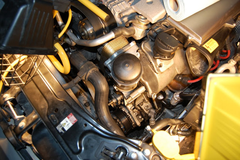

Angry C32 Power steering leak
Power steering fluid is leaking out directly at the pump. I can see drops of fluid falling right next to the PS pulley. With the engine running there is a loud whine, and the power steering fluid is foaming up. After shutting down the fluid escapes through the reservoir cap. So far I have no experience with DIY on power steering, and have some questions. I did change the coolant pump on my 02' Sportcoupe when it failed. There was a valve that opens up, and leaks coolant when the pump goes bad. Do the power steering pumps have this same design? I'm really hoping it's the gasket, and not the pump.
Of course my friendly local Mercedes-benz dealership was of no use as always. I asked the parts guy if the gasket is available. He says, "No you can only buy the entire pump for $650 dollars". I ask who manufacturers the pump. "They don't give us that information". What great service... Tomorrow we are going to take off the pump, and check the gasket. I will just cut out a gasket from universal gasket sheet if that turns out to be the problem. Maybe Autohausaz for a new pump if that's the case. Know any cheaper websites to buy one at?
I'm sure all the power steering fluid will need to be flushed first, and replaced after the job is done. The process for flush might be on the Star service DVD, but I haven't checked it yet. Anyone have DIY instructions to do it properly? Do you think it's the gasket, or the pump?

I wasn't able to find any gaskets for the power steering pump on that website other than the reservoir seal. It isn't leaking from the reservoir. With the PS pulley removed it is clearly leaking from the shaft. I was guessing the gasket we were talking about is what seals the two sides of the pump together. I don't think that's the case though. Is there an internal o-ring, or gasket right at the pulley shaft? With this new information would you think it's a bad pump, or can be rebuilt DIY? Anyone know which gasket commonly goes bad, and if this gasket failure leaks from the shaft? I've searched this forum, and others with no luck. Can't find any DIY threads for power steering pump. Star service DVD doesn't cover repair details, or even removal/install.

ZF Steering wasn't of much help. However, they did tell me the cause of the problem, and that the internals are worn out requiring a replacement pump. Wasn't what I was hoping to hear, and I'm still going to inspect the pump once it's pulled to see if I can repair it.

Does anyone know if buying the pump through dealership will be brand new or refurbished? Turned out the bearings were shot, so it will require replacement. All the ones listed online are cheaper, but they are rebuilt... By the way, can you believe the power steering pump cost more than the power steering rack? The C32 has one of the most expensive power steering pumps for all the AMG models...

The common gasket of failure on the power steering pump is the gasket between the reservoir and the pump itself. Clearly this gasket doesn't seem to be the problem in your case.
In any case, the part number is 0004661880.
It can be found here.
Obviously, you already found out it's the bearing failure that is leading to the leak at the shaft. By the time you source the replacement bearings and parts (if even possible), you probably would have been better off sending it out for remanufacturing. If MB detects a leak other than the reservoir to pump gasket, they just replace the whole pump.
Also bear in mind the following:
You have a 185mm pulley and you are also running a Pulley Saver kit. Think about how those two components may be affecting the powersteering pump (if at all).

Turns out there is two front bolts, and THREE rear bolts on the power steering pump. That third bolt is next to the A/C compressor, and nearly impossible to get at. We were finally able to remove it after finding a small/thin enough shorty ratchet at Sears. Bleed the system by turning wheel lock to lock forty times. Bubbles will flow into the reservoir until all the air is out of the line. Cranked her up, and absolutely no power steering sound. There was also a slightly wobble on the belt drive which is now gone. Running good so far! Wonder how much I saved in labor by DIY. Thinking in the $400 dollar range? I took photographs, so I'll get those up later. If anyone wants a DIY thread let me know... It was a PIA, and a very expensive failure, but the job went well. Just glad to be driving the C32 again!
