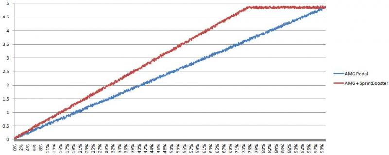

Originally Posted by ThrottleBoost.com
By all accounts, you cannot replicate the affects of the product by stepping on the pedal harder/faster.
Oh really? Think you might want to test that, considering you supply no input that the pedal can't, and on your last generation product, didn't supply more voltage on either channel to the ECU than the pedal did without the SprintBooster.
x-axis is voltage on primary channel to ECU, y is pedal percentage depressed, including the kick-down button.
EDITED : Not 100% clear, but this is with the older, single mode SprintBooster, not the new dual mode.

Fair enough. Please note that I'm not with the manufacturer, so my interpretation of the graph and the feedback from SB users is based on my experience as a third-party provider.
I can see exactly where you're coming from based on that chart - the voltage is there if you stomp on it. The product is sending more voltage earlier, but levels off at the top, indicating that beyond the 2/3 depression point you're seeing no gain. However, I wouldn't assume that the SB is able to provide any more voltage than is available - it's simply altering the signal to deliver it earlier.
There's no doubt that the product alters the way the throttle response feels, though. Those that are using the product have repeatedly reported that the sensation is far different than simply stomping on the pedal.
Because the SB was developed in response to widespread complaints about throttle lag due to drive by wire systems, it's probably important to recognize that the problem area is off-the-line acceleration. From a stand still, getting on the pedal will result in a noticeable lag between depression and vroom... Amplifying the signal will therefore be most noticeable at that early stage. This is consistent with the reports from Sprint Booster users.
Now, because effects of the product are not something that can be measured by HP or torque gain, it's difficult to provide empirical proof of performance. I'm happy to hang my hat on the positive reviews and awards the Sprint Booster has received, though.
