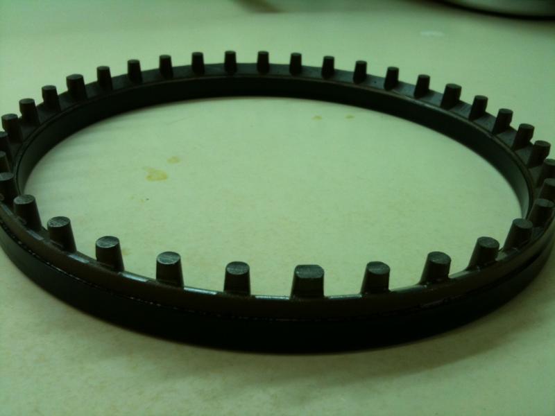

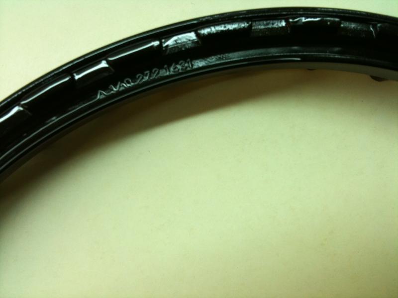

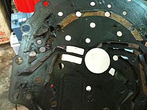

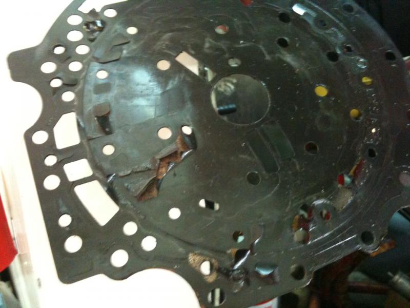

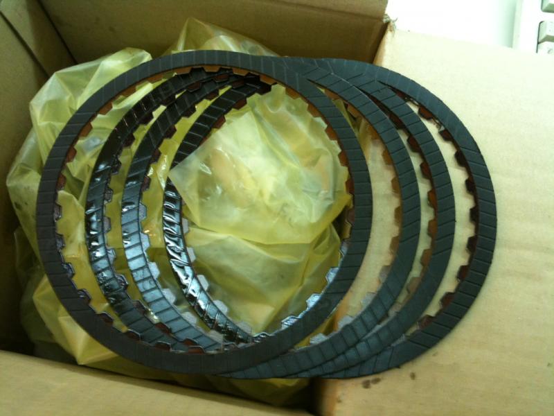

Check out my thread made last week. I had a tranny failure. I replaced the clutches (4 rings) and the piston right behind it and the large metal gasket with some sort of coating/finish. From the pics you can see the gasket has blisters, and my guess is due to high temperatures. it wasn't this obvious when we first took it off, but the blistering was very noticeable, possibly restricting oil flow.
you can actually see how the oil flowed on the gasket, just but the "blistering effect". My mechanic said my clutches look reasonably ok, but i changed it anywayz.
Now I have pretty much eliminated the "tranny jerk". I can go from 1 to 2 gear without feeling and jerk or lockup. Can't say it was the best thing that happen to me but it did address the tranny jerk and I'm very pleased.
