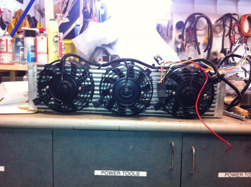

will let you know the outcome when the c32 come out of the paint booth, this will go along as isolated system with meziere 22 Gal per min pump

thats a lot of blockage to the h/e at speed when you need it most.

Are those pusher or puller fans? If you mount them on the inside as pullers like the stock radiator fan it should do really well.
Old Apr 27, 2011 | 11:03 PM
saer1one's Avatar
Joined: Jul 2007
Posts: 1,013
From: Livingston, California.
2002 c32 AMG 2012 c250 Coupe
By the way they are mounted it looks like they will be on the outside..
Old Apr 27, 2011 | 11:44 PM
JUAN CASAUS's Avatar
Joined: Jun 2008
Posts: 704
From: New mexico
2005 E55 AMG
Thats what I was thinking...

it is a PLM with 500 cfm pusher fans

Is there any way to get puller fans that way they don't obstruct the ic?

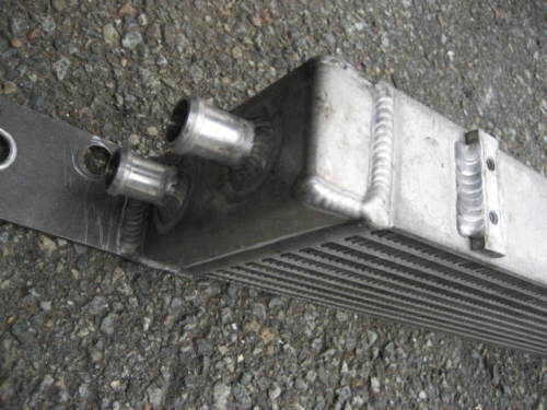

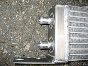

Old Apr 28, 2011 | 10:43 AM
WaveyKat's Avatar
Joined: Oct 2004
Posts: 4,152
Likes: 60
From: NJ, NYC
Something Slow

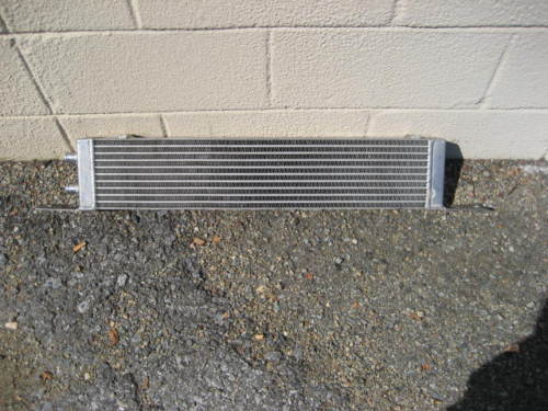

question: how can you tell the difference between the PLM & Code3 Heat Exchanger?
What Brand is in the Pic Attached i was told its Code3
Attached Thumbnails My C32 IC rad setup-he.jpg   My C32 IC rad setup-he-2.jpg   My C32 IC rad setup-he-3.jpg
Old Apr 28, 2011 | 05:45 PM
C32Dan's Avatar
Joined: Jan 2011
Posts: 64
C32
PLM brackets are on top and the core is thicker

Don't believe those fans will help much above 20 MPH or so?? The PLM and Meziere alone should be more than enough to drive down those IC temps, unless you do a lot of stoplight to stoplight, slow driving and profiling??
The Code 3 and Johnson on mine do an amazing job.
The plan is to have them on a switch for in town driving they should help on recovery time between red lights

If they're in front though (pushers) won't they impede the air flow at higher speeds???
I figure with the size of the PLM the little restriction cause by fans will not be a great deal plus I live in Canada where heat it not too much an issue !!

thicker isn't always better. the optimum h/e is a h/e that has the greater surface area to allow more air to pass thru. putting the fan in front simply blocks the airflow. any benefits from the fans will be negated by the blockage

Well I see lots of speculations here about it and its all good, that`s forums are all about its to learn about ea others, that said I do lots of driving in heavy traffic going back and forth to Ottawa, I think the fan shall help in hot temperature, don`t go thinking we have snow banck here all the time we get in the 100 in the summer with 80% humidity. As for the restriction the fans cause well I did my homework on this and all fluids are compressible to some extent, that is changes in pressure or temperature will result in changes in density and go around the fan body. However, in many situations the changes in pressure and temperature are sufficiently small that the changes in density are negligible.
