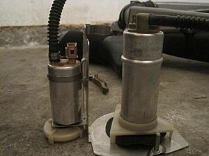

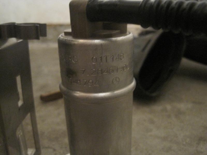

I took apart the fuel pump assembly on the passenger side.
It consists of an aux pump that feeds a canister that houses the main pump. I tested the aux pump and it runs fine. I'll test the main pump next to see if that is the issue. Hopefully these pictures will come in handy to someone else that refuses to pay MB $1100 for a C32 fuel pump assembly. There is no reason why a Walbro can't be fitted to the canister assembly.

The main fuel pump is a Pierburg (part # 7.22013.02.0) and is also used on the E39 BMW's. There are tons of these for sale on Ebay for around $100.. See the thread below for the exact part number:
https://mbworld.org/forums/c32-amg-c...low-rates.html
