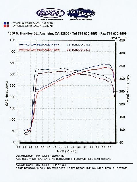

Sorry to keep you guy in suspense, but Nima's scanner is not working well. So he brought the graphs back to me.
Attached is the graph showing a 15 RWHP gain. This is a graph that Raffi at Eurosport did not mention to Brad. Not only did we try the first chip that Nima had dynoed at Evo, but we also had a second chip that was tested.
Also, "C32AMG" showed up today (7/02/03) and we installed the 346 RWHP chip. C32AMG also mention that is dyno'ing his car soon along with his removed rear cat.
The ASE chip is also a dual bank chip where two programs can be stored. You can run a 91 Octane program and the other one can be a 98 or Nitrous program. Programs can be switch easy by a standard toggle switch, push button switch or by factory accessory switch. When the second program is access, it makes the switch with in milli-seconds. Which means you don't have too shut down your car to switch from program to program.
Thank you all for your patience and support.

Sorry to small. Trying again!
