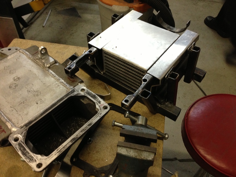

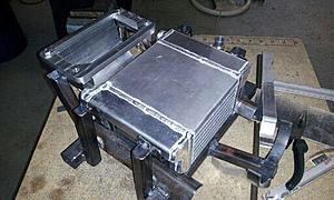

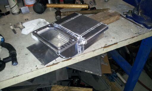

Another incredible thread to follow about fabricating their own single pass replacement IC.
http://www.crossfireforum.org/forum/crossfire-srt6/58947-new-intercooler-core-anyone-oh-yeah-just-got-real.html

rudys i/c is a complete design no oem parts used. all cad design with a bell water to air intercooler core.

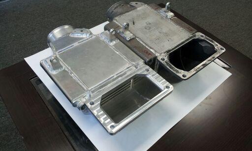

Look what came from UPS today!

SWEET! Now that looks like a quality piece of work!
Let us know how the install goes!
So JELLY!
