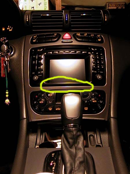

the sound is from the circle area...

I think DL is right
I had the problem just last week and it took them about 4 days to repair it. They have to remove the entire dashboard to fix it. I think everyone has had this problem. I wonder if its a problem on the other C class sedans as well. I got a nice, brand new C240 4Matic as a loaner. Very nice. I was impressed a great deal more than I expected to be. It must be a blast in the snow.

ultraseven,
You are welcome. Make sure when you spray, you need to apply thru entire edge of the A/C unit. Seems like the bottom also make some noise too. Before I only spray the area I circle and not sound until heavy bumps and the sound is from the lowest cross grill below the A/C unit. So I spray some more over there and sound disapper!! Now I'm searching sound to apply the spray.
