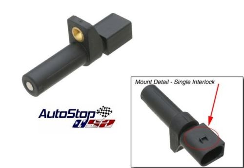

There are 2 types of Bocsh/OEM crank sensors,
*one comes with 1 Pin connector,
*one comes with 2 pins connector,
Name:  CPS 2 pin.JPG
which one you have..?
ZAYED,,

This
Amazon.com: Mercedes-Benz Engine Crankshaft Crank Position Sensor Bosch OEM 0261210170: Automotive Amazon.com: Mercedes-Benz Engine Crankshaft Crank Position Sensor Bosch OEM 0261210170: Automotive
is compatible with my 2006 C55 AMG, in Manufacturer Part Number detail : C55 AMG / 2000 2001 2002 2003 2004 2005 2006
