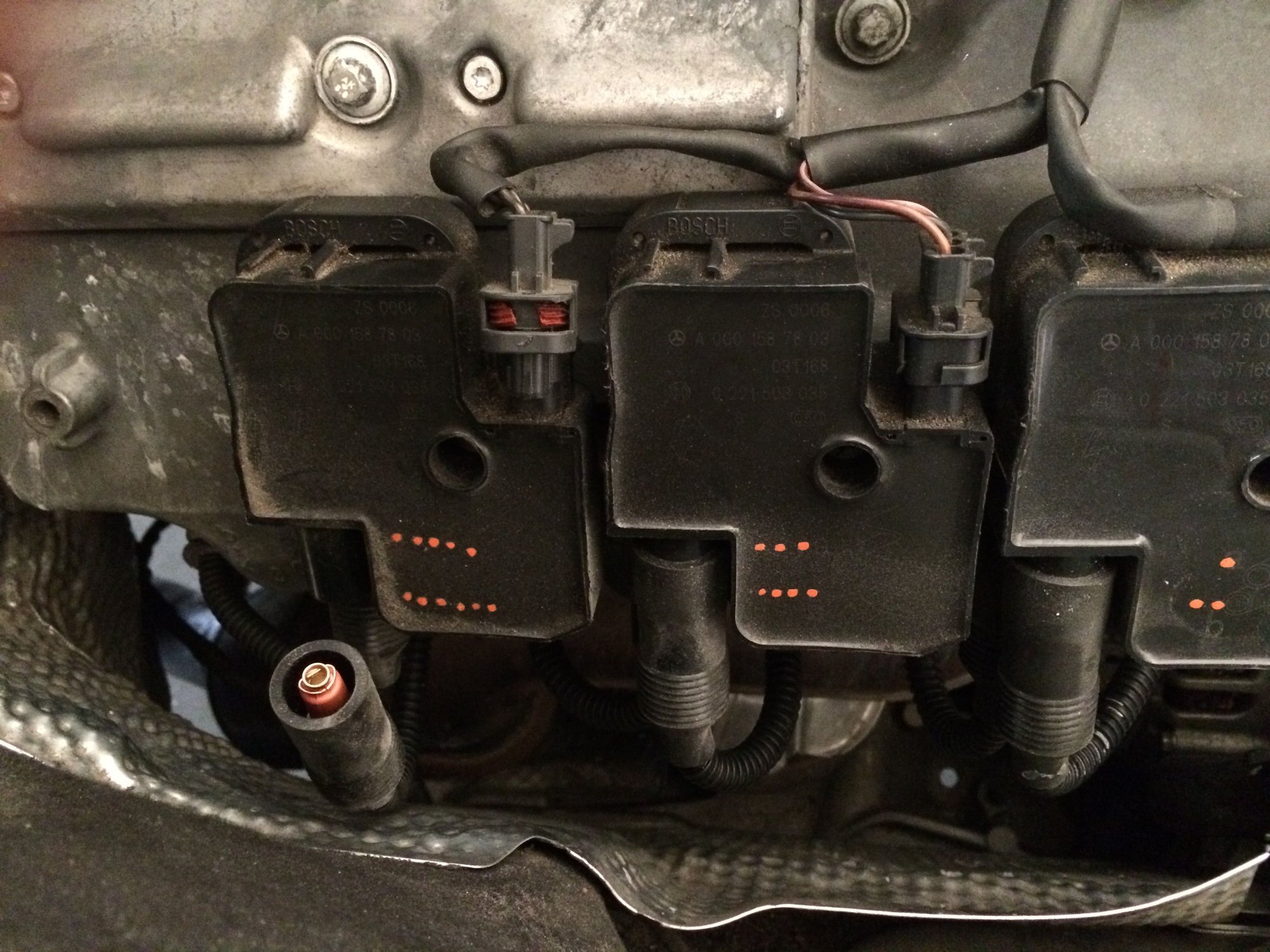

The last time I had my car at the dealer, they forgot to connect something where the arrow in the picture is pointing. The picture is not mine, just one I found online. I am almost having the same miss that was at the time cause by what the arrow is pointing to. My question is how to I get to that area without a huge amount of effort? It looks like a vacuum line is in there. If I have to pull it apart, I
will. Just checking before I begin.

Are all ignition coils the same - in terms of placement?
I see dots on each and they are different. I understand the firing order, just not sure if all ignitiion coils are the same. I need to swap a new one to find the bad one.....at least that's my approach....Plugs and wires are done and this looks to be the next logical step. Thanks.
Bob

SOLVED the miss at idle issue. I hate to say it, but I missed something stupid. One of the plug wires was not properly seated on the plug....DOH. Anyhow, I did not realize this until after I picked up a spare ignition coil and working my way around the plugs swapping out each ignition coil. So, looks like I will keep the extra part in the trunk.....you never know when it's needed.
