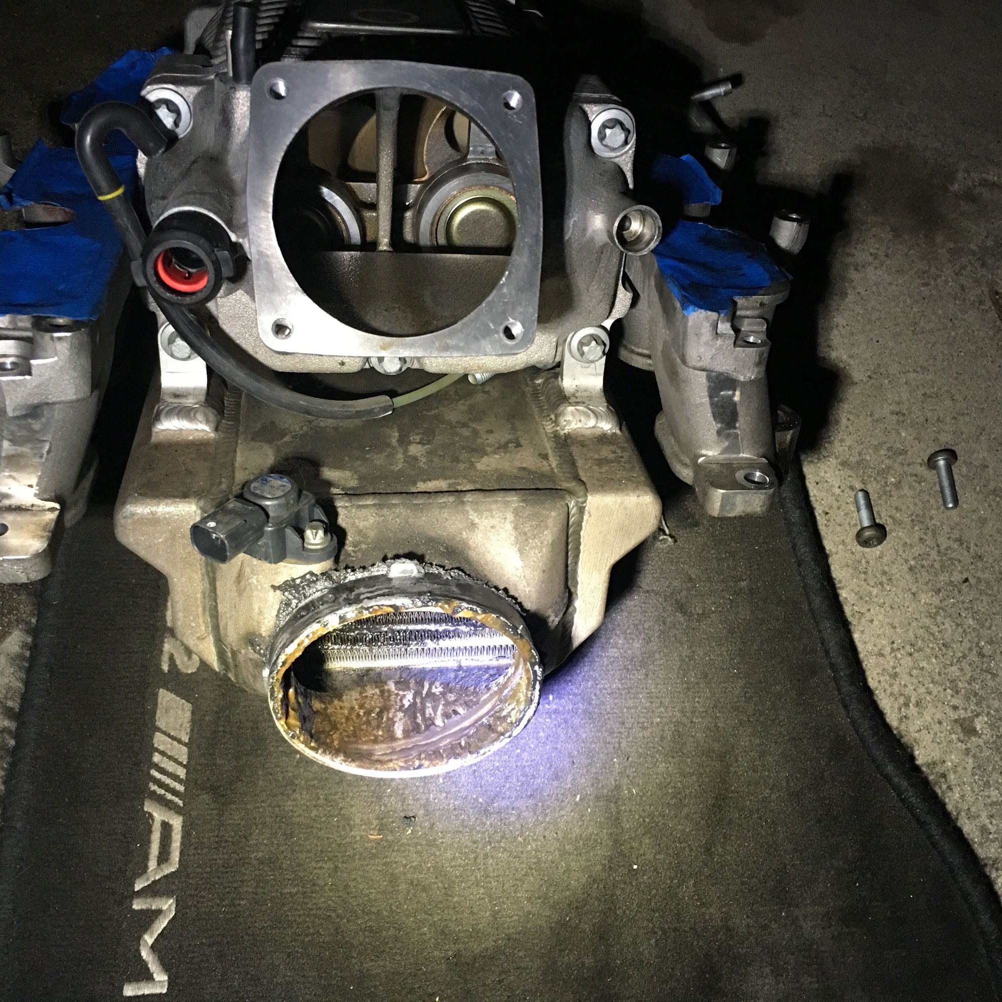

Did any of you guys find black /dark brown cake gunk inside the intercooler and in the AMG manifolds? If that also because of a leaking I/C?

Typically, yes.

I guess its new intercooler time.
